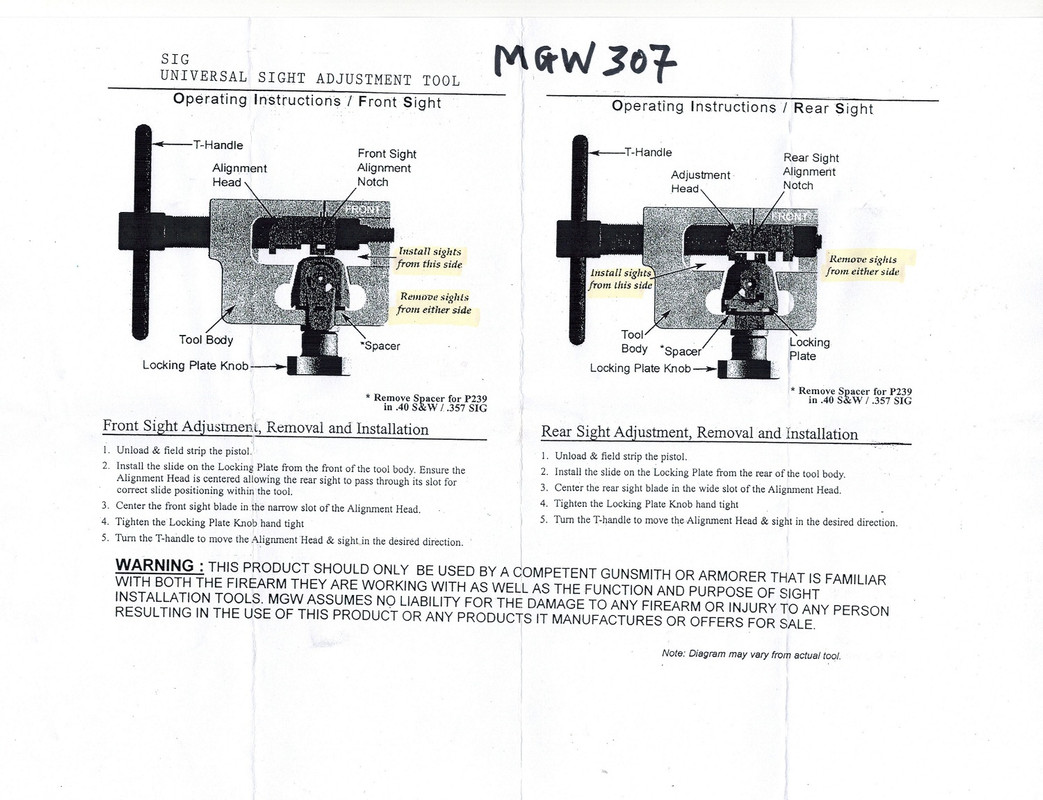

Doing the front sight requires the slide to slide in from different direction than doing the rear sight. That's how my MGW SIG sight pusher works.
Mine looks nothing like that. The bottom part does the rear sight. The top does the front sight. It's marked Sigarms MGW but there is no number.

Those old sight pushers (I have one too) are really only for the folded slides. While some of the milled slides will fit in the rear sight section and allow a sight change, I’ve never been able to change the front sight on any milled slide using that pusher.
