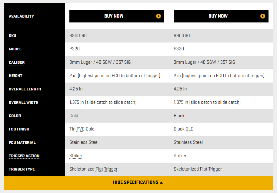

According to SIG, the FCU is the same for 9mm Luger, 40 S&W, and 357 SIG.
https://www.sigsauer.com/p320-fcu.html
