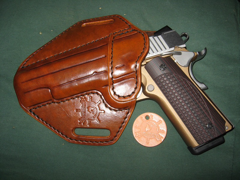

My husband built an 80% 1911 frame for me (Christmas present) with Sig slide, barrel and other parts (plus Harrison Design and Wilson Combat). He Cerakoted the frame and, let me tell you, everyone who sees it loves it. Everyone who fires it wants it.
It's been absolutely perfect for four years, with a LOT of rounds fired through it by me, him and a lot of disbelievers. Not a ding, not a gouge, not a scratch, no wear marks from either shooting it or holstering/drawing from the Privateer leather holster in which I carry it at the range or on our property. Not a single mark.
If applied properly, it will withstand years of abuse. Like any other paint job, prep is all-important, as is a decent spray gun, lots of compressed air with water filtration and the patience to apply several very light coats before oven-curing.
Still looks like that, four years later (and a few thousand rounds, too).
