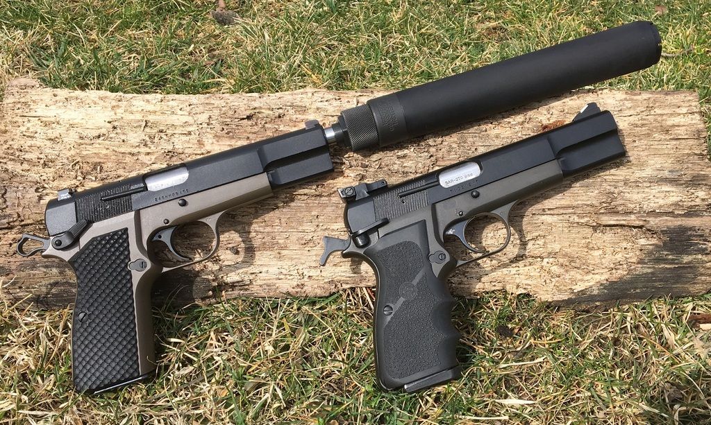

The fundamental questions is if you want to buy another vs. use what you've got and add too it. I ordered a Barsto Threaded for my Hi-Powers and it took nearly 9 months to arrive but now I can swap it in and out between weapons and/or for the original barrel if I so choose. I was leaning towards buying another suppressed host and ended up getting a great deal on the Barsto and I just had to be patient. Which is an issue you won't experience I suspect as P226 threaded barrels aren't that hard to come by... Wink
