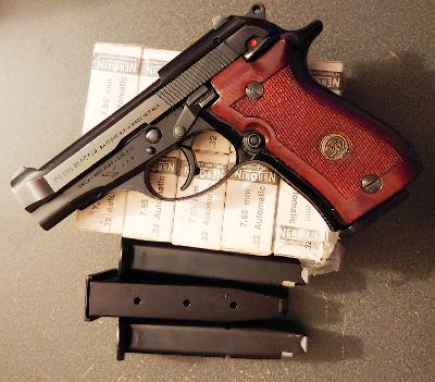

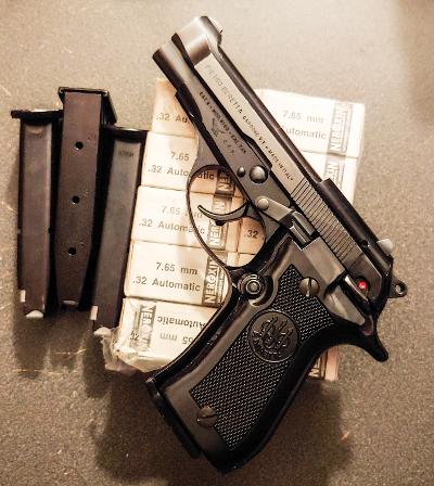

i got my Beretta last week. it was in better condition than I was expecting. I had ordered new plastic logo grips and screws but the lil pistol really didn't need them as the originals were in great shape. It was however, so heavily greased up the hammer would fall in slow motion and the slide was difficult. after 3 hrs of cleaning and reassembling, now it functions perfectly and is absolutely crazy accurate. glad you guys pushed me to spend my money on this lil 81BB. ETA, mags were also full of grease, had to break those down and clean them as well. 175 rnds down range and not one single issue

Very nice! That thing looks pristine, and those wood grips look almost perfect! And yes, they definitely came gooped up. I had to strip down my mags, too, including the extra ones that I bought, to get everything cleaned out. I didn't mind, though...it gave me a chance to inspect everything, and whatever that stuff was it did a good job of keeping rust off the gun.

based on the experiences here, I knew it was going to be in great shape but it was still better than I expected. ill take gunked up over rust all day, everyday
