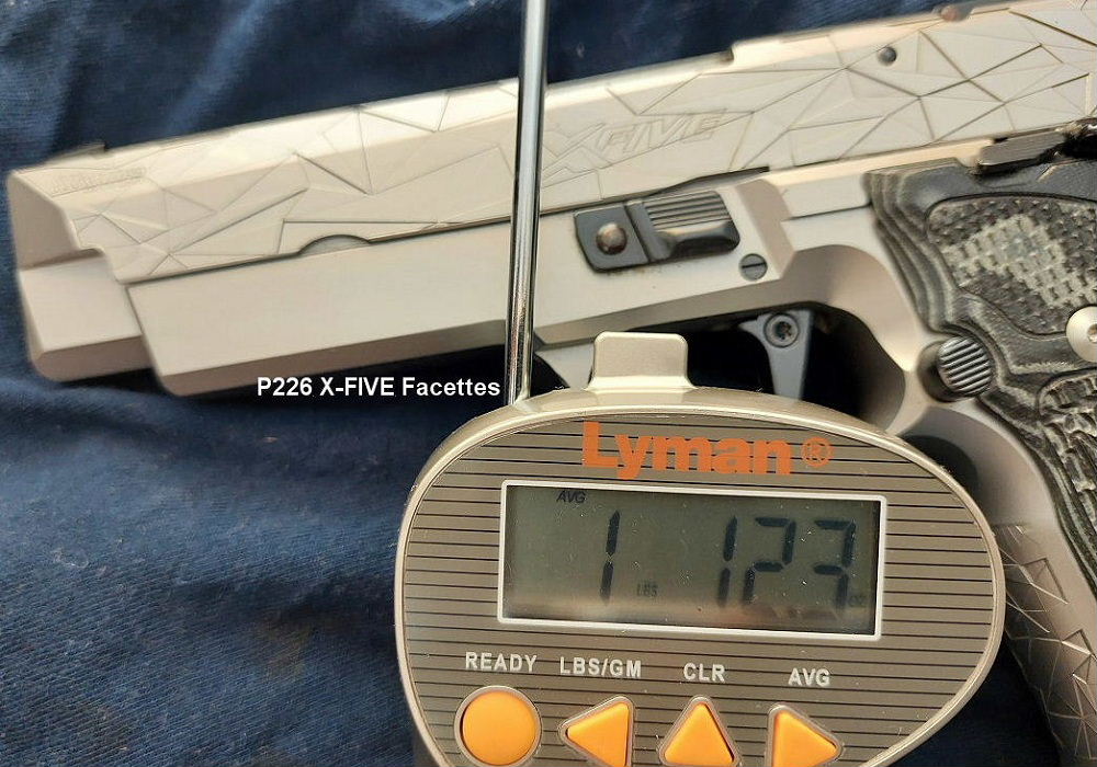

Trigger. The all important trigger. The didgital ( Roll Eyes ) owner's manual says you can adjust the weight from 2.5 to 4 lbs. Mine goes from 2.5 to 3.5 lbs. How does the actual pull feel? Not as good as most German Mastershop guns I've owned. After the pre-wall travel, when you press further to release the trigger, it does not break "like glass rod". When you pull through deliberately slowly, you can definitely feel a tiny smooth (not gritty) slip bfore the sear breaks. I suppose it won't matter, when you press through it without hesitation, because then, it does feel like glass rod breaking. Big Grin

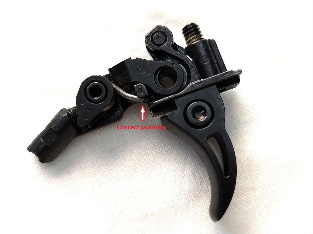

The trigger mechanism, as I mentioned in the other thread, is a complex of parts and not just a simple trigger that many of us are used to. Beware that, if you remove it then put it back, you must have the spring indicated in the correct position, or you will run into trouble.

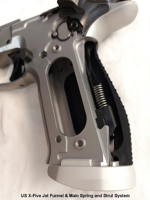

How doe the jet funnel stay put? They came up with new idea that I think is more clever than the German way. The new jet funnel has the built-in tab in the rear that, after sliding onto the botton rails of the grip frame, is held firmly in place by the new Hogue grip design. No screw needed to attach it to the main spring seat's bottom like in the German jet funnel.

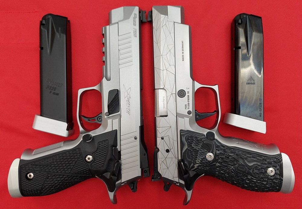

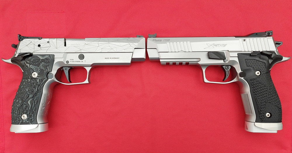

Comparing it to the German Facettes
1- Beavertail on the German is a little longer.
2- Dust covers and front of slides are of different profiles. So, the German upper does fit in the US frame, but the US upper will not fit in the German frame. The barrels themselves are not interchangeable, due to slight dimensional differences. So, although the German entire upper fits in the US frame, I would not attempt to shoot it in this Frankenconfiguration.
3- The recoil springs are surprisingly of drastically different lengths. The German one is much longer. The recoil assemblies (RSA) are constructed differently and are not interchangeable.

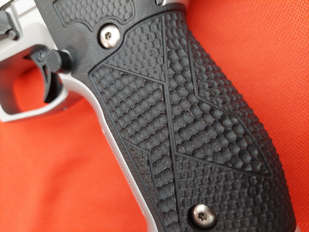

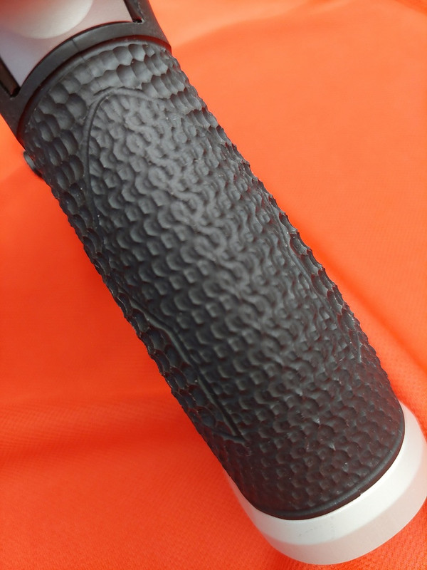

4- Grips are slightly fatter on the German gun, due to the "X" that is above surface compared to the one on the STAS that is flush with the surface. German grips are not interchangeable with the US grips, whether they are the old Gen1 (original) or Gen 2 (Enhanced) guns.
5- The extractors are obviously different. But, as mentioned in the other thread, I'll just have to live with the long external extractor. Big Grin
6- The STAS has the 18-rd Mec-Gar AFC mag body Plus 2 base. The Facettes has the 17-rd polished blued Mec-Gar mag body Plus 2 base. Mags are interchangeable.
7- As noted above, the SAO safety mechanisms are different.
8- Not shown, but the trigger complex on the German gun is slightly different.

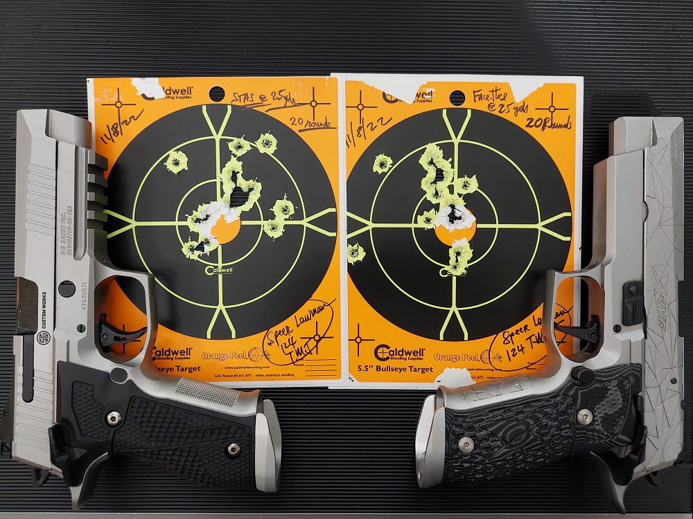

Part 2 - 11/11/22 Shooting report
First, I cannot believe I haven't gone shooting at all since March 11 this year. With too many other things going on, coupled with the lack of motivation (aka laziness), and you got yourself 8 months of rustiness.

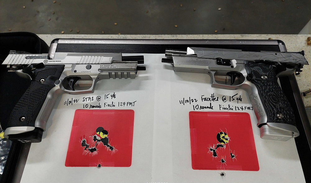

So, with the new US X5 as motivation, I went to the range 3 times this week, dragging the Facettes along for head-to-head shootout. Big Grin Total of 400 rds through each gun.
1st day, ammo = Speer Lawman 124Gr TMJ. Shot 200 rds through each gun.
2nd day, ammo = Fiocchi 124Gr FMJ, Geco 115Gr TMJ, Magtech 124Gr FMJ, SIG V-Crown 15Gr JHP. Shot 100 rds through each gun.
3rd day, ammo = Fiocchi 124Gr FMJ, Geco 115Gr TMJ, Magtech 124Gr FMJ, SIG V-Crown 15Gr JHP. Shot 100 rds through each gun.
Observations and results:
1- Trigger - Going head-to-head, I was surprised to note that the STAS trigger pull was clearly heavier, not because of the slip mentioned above, but it's actually heavier than the Facettes's trigger pull. I had, without measurement, assumed that the last time I adjusted the Facettes' trigger to lightest, it would be at 2.5 lbs. Wrong! When I got home, I decided to measure both with the Lyman digital trigger scale. The STAS was at the expected 2.5 lbs (average of 10 pulls), but the Facettes was at 1.75 lbs! Not only is it very light, but with crisp break and zero creep/slip, it made for a pleasant shooting experience. As to trigger profile, I much prefer the curve one of the STAS. Never been a fan of straight trigger.
2- Sights - Definitely like the fiber optic front of the STAS.
3- Barrel finish - As mentioned above, the STAS' barrel hood uneven DLC finish was either from sloppy prep work or from a lot of factory test firing. But, after having 400 rds through the gun without seeing any noticeable wear, I'm convinced that it was poor prep work.
4- Hiccups - 2 FTExtract on the first day with the Facettes. One failure to completely chamber the next round on the 3rd day with the STAS.
5- "Accuracy" - In my shaky and rusty hands and my aging eyes, not too great. All shooting was done with the butts of the guns resting on the aluminum suitcase. Despite the trigger differences, with the STAS' trigger honestly annoying me at times, the two guns overall appear to have the same accuracy in my hands.
So, in conclusion, I'm very happy with both guns and had a great time this week, after such a long layoff. The STAS could definitely use some clean-up of that trigger "slip". Hey, I'm a trigger snob. Razz
