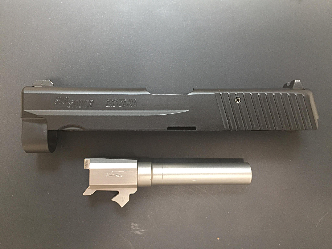

If anyone's wondering what Poly-T2 looks like (since they don't have any good pics), here it is on a P225 slide:
It seems to be a little more matte than Roguard. I like it. I was originally trying to go for the "K-Kote" look, but I think I like this better.

Good deal! I had a slightly holster-worn 1994 model that I already paid too much for, so I thought I'd give it a shot.
It's a thick, tough finish...so just beware...it will change your parts tolerances. But they guarantee it for life against chipping. We'll see, but I won't be the tester.

T2's definitely not for every application. They had to fit the barrel back into the slide in order to make it go into battery, which kinda surprised me. I thought it might wear in, but that barrel wasn't even TRYING to go into battery until they fit it.
Lesson learned...send the whole gun in so they can make sure everything fits.
I like T2 for the purpose I chose it, but it has limits.

My P228 was sent back to Sig for NP3 on the slide (ages ago) and that’s what it looks like. And the barrel looks like my Robar P229.

I like NP3+ for this particular application, but it's more matte than the original and not as slick. I'd probably just go with the original formula for small parts jobs like trigger groups and bolts. Anything larger like a barrel, frame, or slide....I'd choose the more matte NP3+...YMMV.
