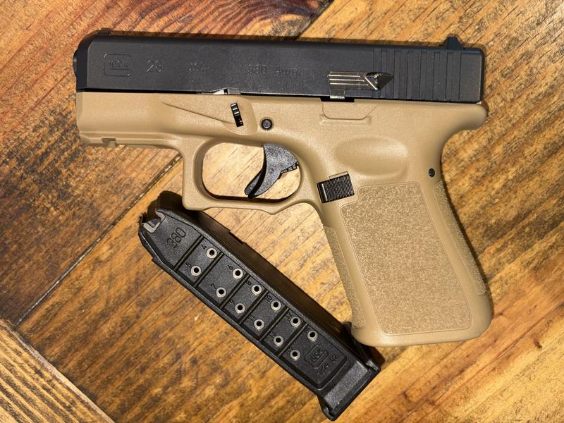

Here is my G28X .380 configuration. I assembled this. Very good shooter. I swap my G26 and G28 slide back and forth. Works perfect with both. (Glock store M1X frame)

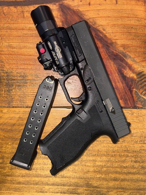

Here is my G25X. Glock 25 .380 slide on a PSA Full size-S frame. 17 round .380 mags by Promag.
How do you like that configuration with the 380? Are there any issues with certain ammo types. I like that option. I kick myself for not getting the used Glock 25 my dealer had a couple months ago. I would have bought it for my wife. Wink

The G28 uses a strong double recoil spring - same as the G26. Weaker ammo can be problematic. So far, AAC ammo from PSA is too weak (failures to eject) and Browning flat point had a failures to load once or twice. Every other .380 load I tried worked fine. Every JHP load worked perfect.
Never any issues with the G25. G28 works perfect with decent ammo with above bunny fart power factor.
These guns are such cool shooters. Shooting a G19 size gun with 50% less recoil is pretty fun. Back on target so fast.
