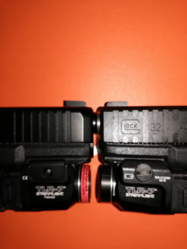

Chowser
my gen3 32 next to a 45. you can see that the dustcover on the 45 is a little thicker/taller
