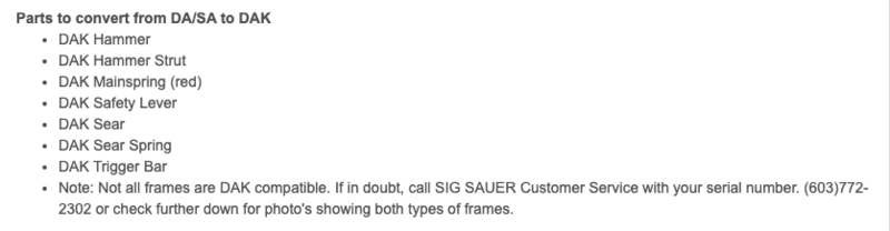

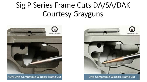

If you are somewhat mechanically inclined and can detail strip a Sig P series it's not hard at all. I have done a few. The issue can be cost (if you buy all of the parts separate) and do you have a DAK compatible frame. For a while after the DAK came out all of the Sig frames I saw were DAK compatible then as DAK faded I ran across some new frames that were not. I actually bought a newer (2014) P229 9mm with the intention of converting it to DAK but when I got it I found the frame wasn't compatible.
I have had the best luck buying take-off DAK parts online. I think the most I paid was around $70 for everything.
Here is a parts list from TopGunSupply of whats needed.
And here are a few pics of the different frames courtesy of Grey Guns.
Thanks guys! I guess the first step is to see if the frame will accept the required parts and proceed accordingly.
