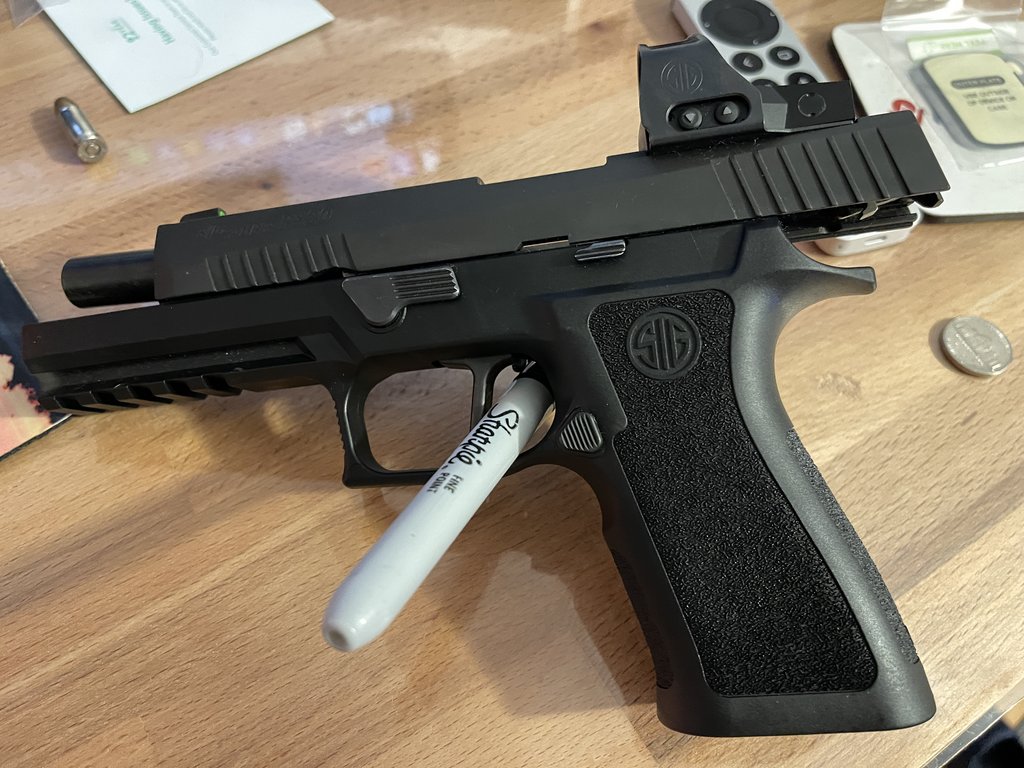

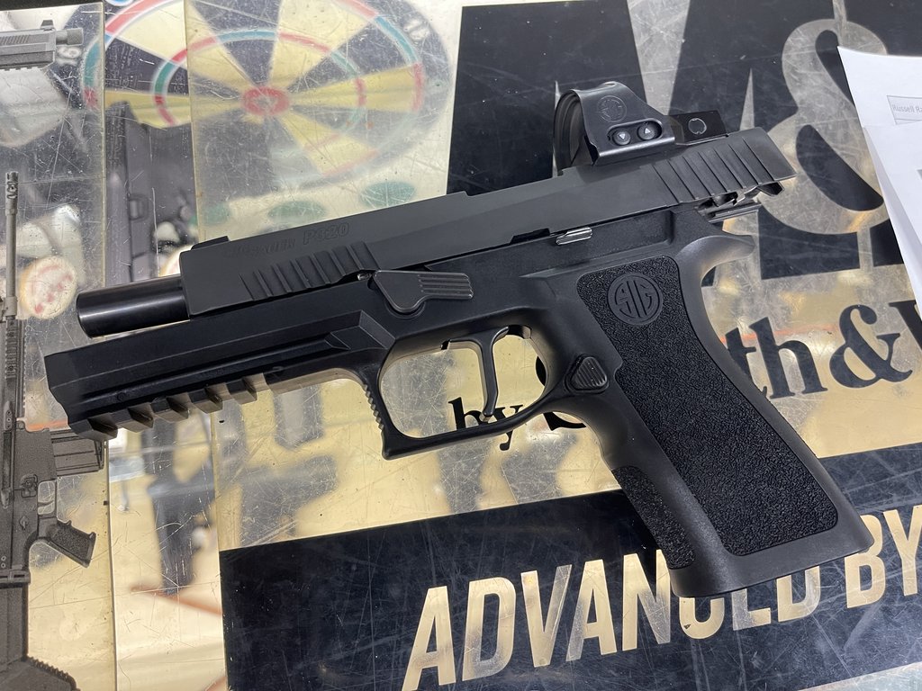

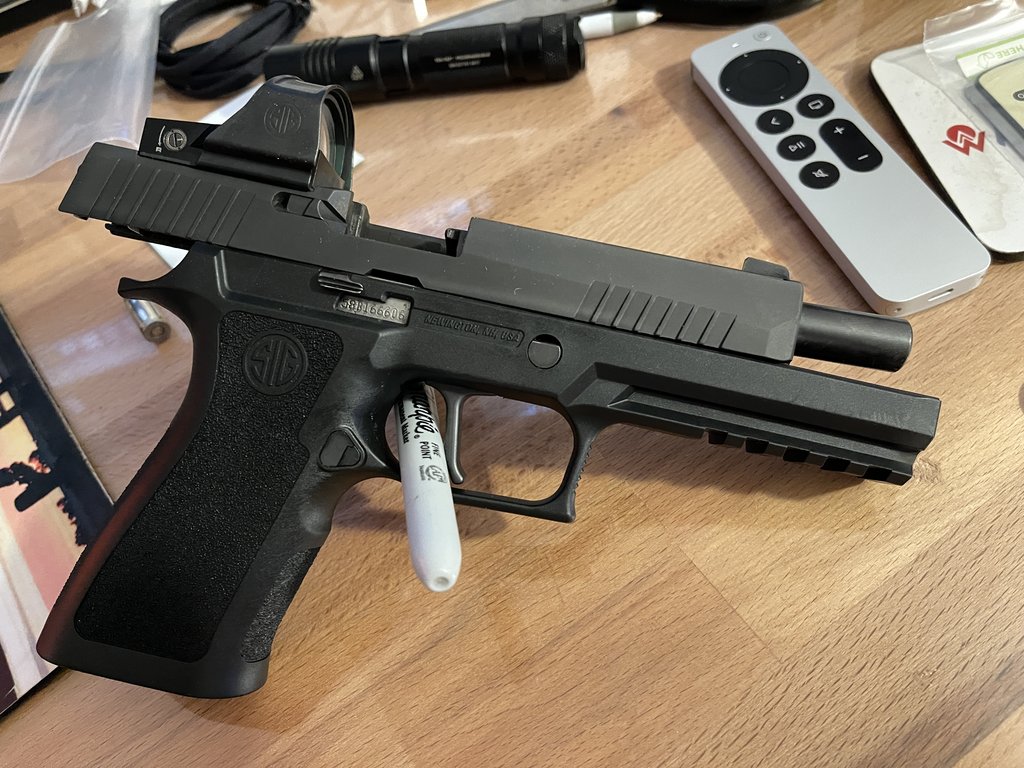

So couple weeks ago had a Saturday morning pistol league round 4 of 4, down to the last 20 rounds or so. Firing left handed single hand, last shot gun fired, but oddly the spent casing did not eject. Gun locked back and a simple huh well ok stuck my finger in and knocked the casing out. A second later went to go safe on the gun with a locked back slide for the next corse of fire and oh, wow the gun is locked and wow the slide won't move. Had three other with myself all try to move the slide to eight forward or locked back. Yeah not happening. Finished the course of fire with my Glock 43X MOS and got 2nd place, but I was ok with that. The stores gunsmith looked at it said maybe a bulged barrel from a squib load.
Ammo I was using was brand new Fiocchi 115GR FMJ in a white box made in Ozark, MO.
I'll be calling SIG to see if they will help.

If the barrel is bulged, you should be able to see it from the inside of the barrel.
Did you try to take off the back plate, remove the striker to see if you can get the slide off?

I think you would have been able to detect a squib load... possibly the rod & recoil Spring turned?

Yes I’ve pulled the back plate no luck, the barrel doesn’t look bulged.
Never noticed if it was a light load on the squib.
Several of us have messed with the guide rod and moved it around its free moving, rotates and is not an issue.
Any think it could be the chassis?

So the slide will not fully retract to allow the the slide lock to engage the slide cut? And therefore you cannot rotate/remove the slide take down lever.
Is this one of those models where the optic mounting screw come up from the bottom/inside of the slide?

Sounds like you had a squib that got pushed out. During our fall range, we had a squib that wasn’t detected, got pushed out by a follow up shot, and it locked the gun up as you describe. The bulge was really minor and hard to see with the naked eye.
I’ve seen squibs with just about every manufacturer. It’s a mass produced item, and it sadly happens enough that ammo companies usually buy a new barrel no questions asked. At least that’s been my experience in LE.
And technically it’s not a kaboom. Every 320 I have seen go usually blow the magazine out the bottom, always blows the extractor out, and usually cracks the grip module around where the serial number is.

I am confused by a couple of comments here.
The P320 does not have a locking block. The barrel cams on the slide catch lever pin, and that’s held in place within the receiver by the trough of the grip module.
The gun in question is evidently a full size P320. The recoil spring guide of that model is round, and it doesn’t matter how it’s oriented on its long axis. If it rotates nothing changes. Or does “the rod & recoil Spring turned” mean something else?
I agree that the most likely explanation is that the barrel is very slightly bulged: it wouldn’t take much to prevent the slide from moving fully to the rear.

Is the recoil spring captured, or does the spring have exposed ends?
Rephrasing the question- are you using the stock RSA or have you moved to a non-captured system?

Will be interesting to find out what the problem was... full size p320's must have a different guide rod than the compact. On my compact the rod has to be oriented in a certain way. the back is not round but oblong.

Is that one of the models that has the red dot mounting screws underneath the slide? If so, could a loose screw have dropped down and jammed the action?

That was my question also. Looking at the RD and the fact there is no rear sight, I'm inclined to think it is, and that's where my $$ is on why the slide if locked up

So in order to take off the rear iron sights yes they detach from underneath. but the RDS does screw in from the top down. RMA to SIG is the FED EX system,

It shouldn't. The only screws on the underside of the cover plate are removed before installing an optic. If it was a screw jamming the slide, it would be one of the screws holding the optic on from the top causing it.

If the barrel is bulged and the slide can't fully retract, isn't the only way to get the slide off by cutting it off? If so, would they replace the slide and barrel on their dime or expect the ammo manufacturer to foot the bill? Maybe get them to replace it with a PRO-CUT Slide with suppressor sights and a bare stainless finish. Might as well get an upgrade if you can.
