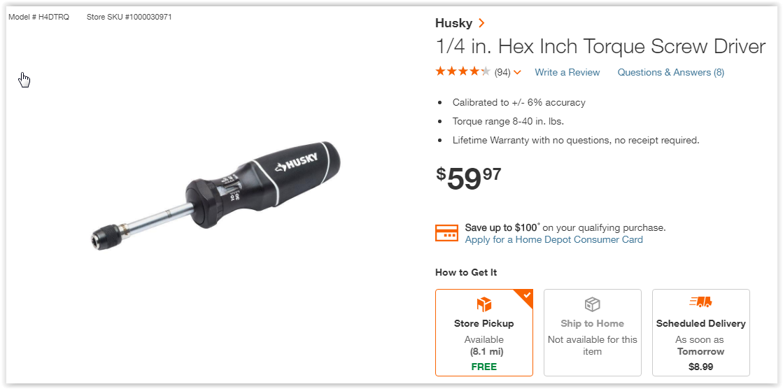

Wheeler stuff has never impressed me.
People buy it and like it, but it looks cheesy to me.
I hemmed and hawed over this same thing not long ago, looking on line, etc.
Nothing turned me on.
I had a Home Depot gift card so for the hell of it I looked at their offerings.
Lo and behold, they had a Husky branded torque screwdriver that is a pretty darn good product.
It has a case, it's heavy (I like heavy) and it worked as advertised.
The chuck is rugged.
When it "breaks over" it is definite.
