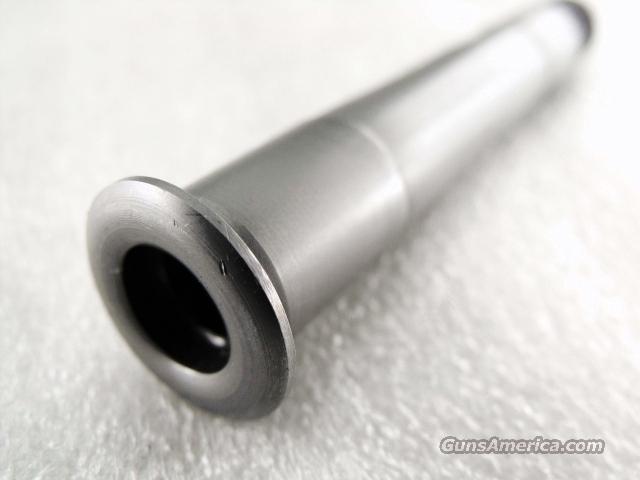

You can see a locating pin at the top rear of the shroud which will mate with a recess on the frame front to keep the shroud in alignment. The barrel is larger than the hole in the shroud (flanged), and the barrel is screwed into the frame holding everything together. A special key that fits the rifling is used to screw the barrel into the frame, same as S&W.

I figured without a nut it had to be something like that. The exploded diagram shows the barrel going down the sleeve from the front, not the sleeve over the barrel from the front. I just had no idea you could torque on a barrel using a key and rifling.
I'd like to see a Redhawk barrel disassembled. There just doesn't seem to be anything out there right now to look at. Ruger doesn't sell the parts like S&W does. For work, one would have to send the revolver to them.
So, this is a S&W barrel:
Assembled holding the shroud on:
Still looking for an image of what the sort of wrench used to put this together looks like.
That's pretty cool...I'd love to see how that works.
