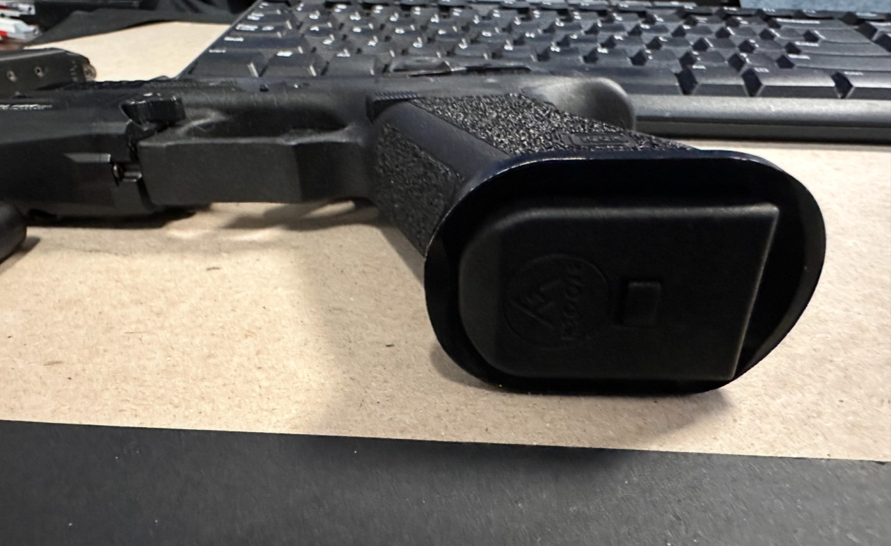

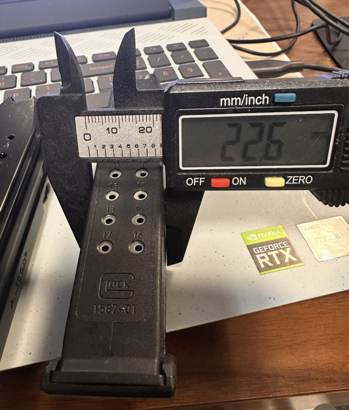

Looks good, feels good. Only issue is it sticks in my duty gun. I'm wondering if getting the grip stippled cause some changes because regular mags drop fine. I tried the MecGar mag in other people's stock guns and it drops free. So that's something to note. If I can find my calipers tomorrow, I will measure it. I'll measure a stock mag as well.
We just did two boxes of ammo (100 rds total) and had no issues. It locked back when empty every time. No misfeeds. I'll check to see later if over-insertion is a problem.
--ETA-- It was the magwell. I removed it and the mag drops free now. It's actually the magwell screw. If I back it out a bit, then it works fine. Guess I'll shave the screw down.

It was also reported by Skipz Guns on YouTube that the base plate will not work with the magwell on the Fusion XP Pro, so it sounds like Magwells are going to be a check and advise.

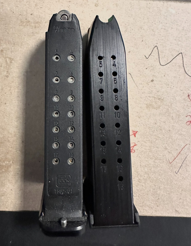

ok my fingers are tired of loading one mag (i'm old and someone stole my uplula). did two more boxes of fmj and one box of jhp. no issues. i'm done testing. lol. 100 rds of speer 124gr tmj and 50 rds of speer 124gr +P gold dot jhp.
looks like mecgar mag is minutely longer front to back.

I have seen the lip of the magazine base plate not work in some Glock magwells because of what I call the "underbite" baseplate. That's the majority of problems I see with the magazine being used. I don't know if that can be cut off and keep everything working or not.
