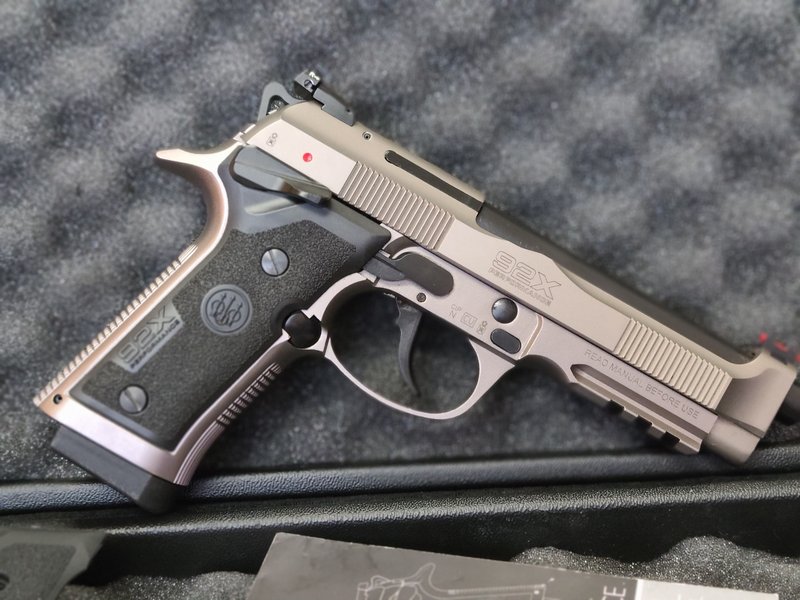

I bought a 92X performance the other day and had a nice range visit yesterday, very sweet shooter
Anyway, as I was cleaning it I saw gunk under the locking block and pulled it out. Not realizing it's not suppose to come out without removing the pin holding the retainer in place, I couldn't get it back in.
I didn't have a small enough punch, so I bought an Irwin set that has a 1/16 punch in it. I also ordered a locking block kit today from Wilson just because
I tried the 1/16 punch when I got home and it is just bending, it's one of the longer ones. I gave up thinking it might be smaller than 1/16 and I didn't want to ruin anything
So, does anyone know what size this pin is?
Where can I get a quality set of stubbier punches?
Link to Wilson
https://shopwilsoncombat.com/B...ies/productinfo/786/
Pic of gun that is now in pieces Frown
