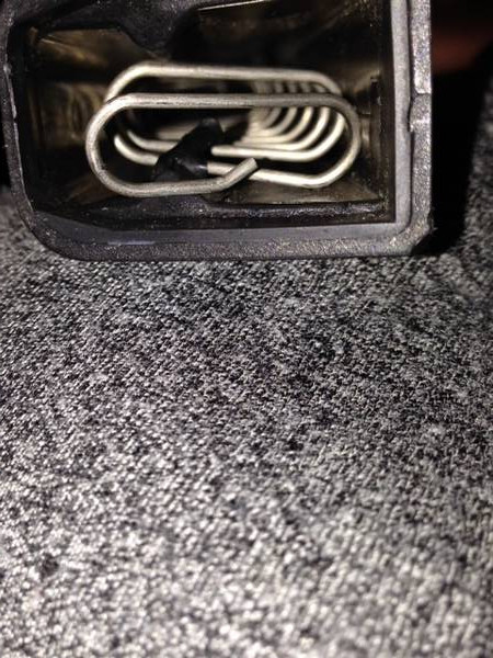

I've had a brand new Glock mag that would not load past 8 or 9 rounds. Took it apart and found that there was some excess polymer flashing from the mag tube was lifted up and snagging on the spring.
