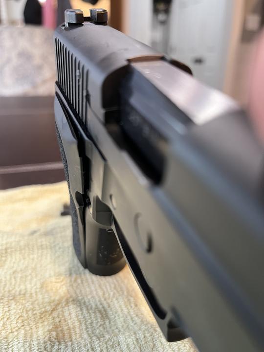

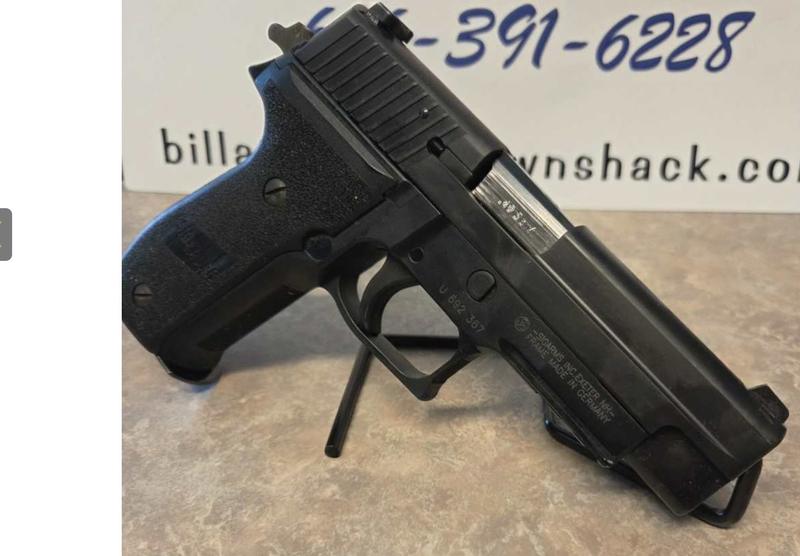

Quick question if anyone can help please. I just picked up this great condition P226 40cal pistol for $375.00 and my plan is to drop in a .357 barrel since it has the black stainless slide on it.
This pistol has the German Lower and the US upper (correct me if I stated this wrong). I have a NIB set of E2 grips that I went to install and they almost fit but do not “snap” flush to the frame. There is about a 1/64” gap on the right side of the pistol (ejector side).
Can anyone advise if any E2 grip unit will work with the German Lower or if there is a modification I can make to the E2 grips I have work on this pistol?

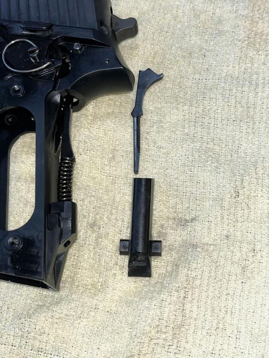

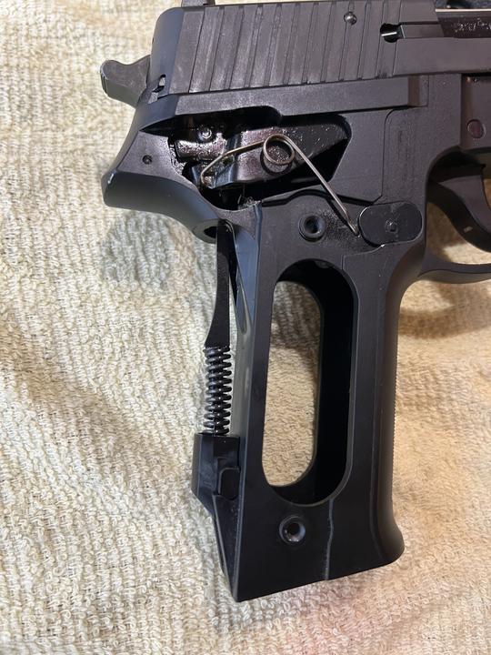

Q - Thanks for responding. Guess I should have included a few more pictures with my first post. The photos below show what was on the pistol (sitting to the side) vs. what I changed out that was included in the E2 Grip Kit. I used the same spring.
Your thoughts as to if I am using the wrong parts?

The one installed in the gun right now is the correct E2 assembly.

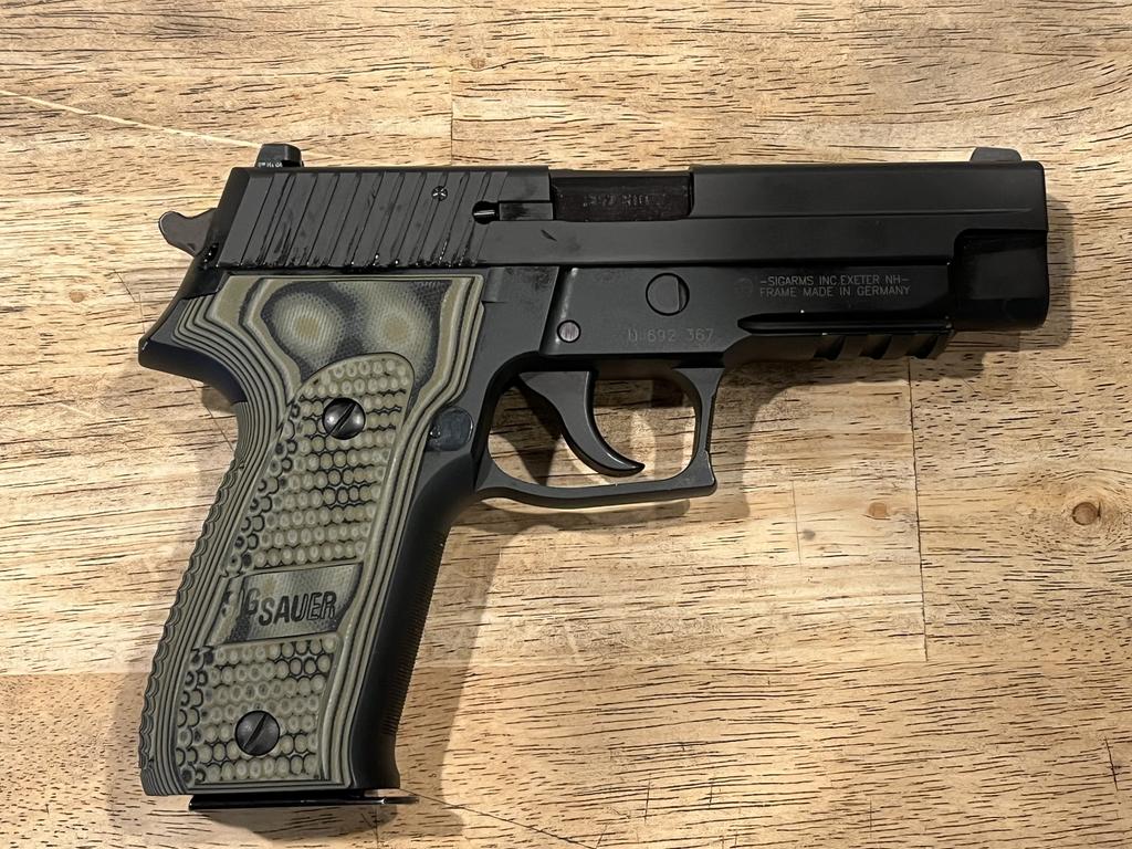

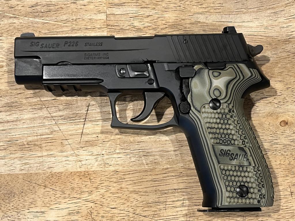

For now I will utilize a set of G-10 grips a forum friend kindly gave me with one of my pistol purchases from him Wink.
In fact these feel great on this pistol. May need to leave these on this new member to my small collection.
Now to get out and shoot this .357Sig caliber pistol (dropped a Sig OEM .357 barrel in it). Lord knows I have plenty of ammo now Big Grin
