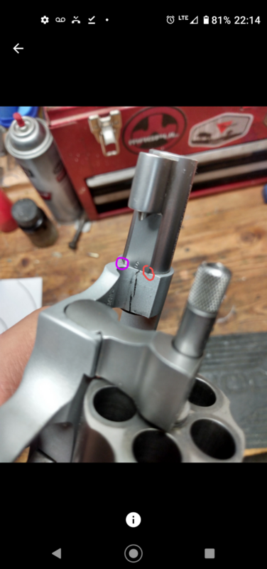

I got it out to the range this afternoon, but again didn’t have a bunch of time and didn’t do my usual clean and inspect routine with a new gun prior to going. At the range, the thing was grouping like crap, and consistently to the right…a full 4-6 inches right at 10 yards. I tried the same loads in my 360 with no problems, and even swapped over the grips from the 360 to make sure it wasn’t that…no change. I went home frustrated, thinking that I’d give it a good cleaning and go back tomorrow and try some different loads and bullet weights, hoping to maybe find something that it liked.
I got it home and started cleaning, and the first thing I noticed was this weird bump on the muzzle crown, just below the front sight at around 1:00 O’clock. It’s barely visible, so I’d missed it at the shop, but you can feel it. It’s not a gouge or scratch…it actually sticks out from the front of the muzzle like a pimple. I have no idea what would cause something like that, but I figured that it might be enough of an anomaly to be causing the gun to shoot to the right, so I figured maybe the thing needs a re-crown. Annoying, but not the end of the world.
Then I found this. I have no idea how I missed this at the shop, but there it is…the frame is cracked all the way through under the barrel. I don’t know if it was mostly closed up and expanded when I shot it, or if it was already split like this and I just missed it. But there’s no way anything I shot through it today caused this…it was just powderpuff .38 special reloads (I’ve shot hundreds of them through my 360 and other guns with no problems) and 5 rounds of Winchester PDX1 +P. None of the rounds fired felt particularly hot or out of the norm compared to the others.
So now I’m stuck with a busted gun. I guess I should be grateful it didn’t blow up in my hand, and it’s a clear lesson to look used stuff over a lot better before I buy (or shoot it). It was a consignment gun, so I doubt the shop will be willing to take it back. I’m planning to call them Monday, and if they won’t, I guess I’ll give S&W a call and see if they can help me. Not sure if they will since I am not the original owner, and they’re in no way obligated, but it doesn’t hurt to ask. I should have just left well enough alone and kept using the 360, snaggy hammer and all. Not the best day ever. Frown

Is the front sight bent, or that's just an optical illusion?
I noticed that too and was about to dismiss it as an optical illusion, BUT in the last picture, just to the right of the frame crack, the flat on the underside of the barrel appears to have an edge that extends ever so slightly below the frame surface, and the opposite (left) side of the flat appears to extend by the same displaced distance above the cracked frame flat, which suggests to me that the barrel is slightly torqued off-center.
I'm wondering if the barrel was over or under torqued during assembly...or possibly the barrel was removed/ torqued after it left the factory...OR, conversely, perhaps the frame cracked first and allowed the barrel to twist afterwards.
Agree on the bad barrel install. I think thats what cracked the frame.

That's my plan. I don't blame the shop...I missed it, can't fault them for doing the same. Honestly, I can't even blame the guy who put it up for consignment, unless he knew about it and put it up for sale with the intent of dumping it on someone else. But good luck proving that. Also, who knows how much he even shot it...it was really clean, and it's not like these tend to be high round-count guns. It probably spent most of its life up until now in a nightstand.
It's even possible it didn't crack until I shot it...although I still say nothing I put through it SHOULD have caused that...and I doubt it because it was shooting to the right from the first round. Ultimately I should have inspected it closer, and done better research (although admittedly, it is easier to find information about a problem AFTER you know about the problem...you don't know what you don't know).
From the research I've done tonight, it appears there were a batch of these that left the factory with overtorqued barrels. I haven't been able to find a definite serial number range, but there's at least internet consensus that it happened. So it's entirely possible this gun hasn't been right since day one. On the upside, I'm reading really good things about S&W CS taking care of people, so maybe all is not lost.

I had co-workers who abused S&W snubs that were not +P rated and I saw a couple fail. When they did, the top strap cracked or let go. I dont think I have ever seen one that failed in the area that yours has. Thats what leads me to think its a faulty barrel install.
Posts: 17721 | Location: Marquette MI | Registered: July 08, 2014Reply With QuoteReport This Post
Well, here's hoping S&W reaches the same conclusion, otherwise I'm out $450 Frown.
