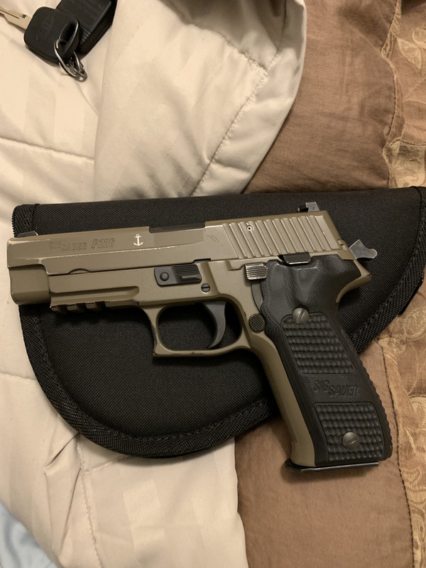

So I picked up a well loved MK-25 a while back. It seems the recoil spring is very soft so I was planning on replacing it.
Are there any others that I should replace at the same time?
Is Wolf the go to brand?
What weight should I go with?
Thanks for the help.

Well loved = well used.
If you haven't done so already, might as well change the TBS and the slide catch lever springs while you're at it. And, maybe the decocker spring, too, but that's probably not that important.

Thanks for chiming in. Yes it is well used. Is there an online guide on how to detail strip it?
Is the 14 lb spring a good choice? I see conflicting info as to what is factory.
Here’s a picture of the gun in question.
Posts: 1148 | Location: DFW | Registered: January 12, 2009Reply With QuoteReport This Post
YouTube has tons of how to videos. https://www.youtube.com/result...l+strip+the+SIG+Mk25
But, you don't really need to detail strip everything, just semi-detail for those springs. And, why not just use factory recoil spring? I have a factory Mk25 parts kit (minus the grips) NIP that member WJR kindly gifted me a couple of years ago when I bought his P226 Combat. I no longer have the gun and really have no need for this kit. All yours, if you want it. Just email me your shipping address.

See, I used to think like this. Let me explain why that is no longer the case. I will agree that, if you bought a gun, from a private individual, that is NIB/NOS/LNIB, I wouldn't do anything. But, if the gun has been well used, like OP's case, you really don't know. It could well be fine. But, it could also be at the stage, or passed it, of small parts exceeding useful life. And, if you keep using them, you only risk harder pounding on your pistol unnecessarily, which could lead to its premature death. This is from personal experience with the Nickel P228 I tested last year. Spring are cheap. Replace them, when you're facing the unknown. OP's well used gun's recoil spring is "very soft". There are no good reasons not to replace it, although it still might cycle the slide.
