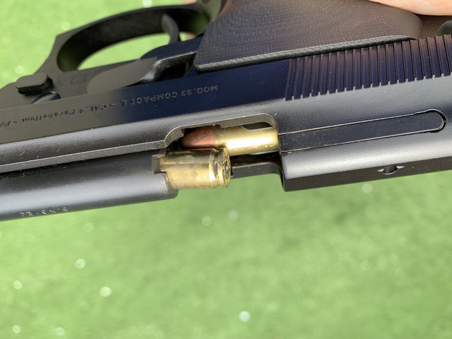

I was at the range with my Beretta 92C, VP9 long slide, M&P 2.0, and CZ P-07 (don't worry the other pistols come in later). I have had issues with FTE during one previous range visit with the 92C but had initially blamed two mags which I marked. One was a 15 round compact Mec-gar and the other was a 17 round full size 92 mag with an x-grip.
Fast forward to my recent trip and the 92C again had several failures to extract which lead to double feeds. To answer the questions I know will come, with good reason, I have installed a factory "D" hammer spring and "G" (decock only) conversion kit on this pistol. The gun has maybe 500 rounds through it. Also, the ammo was factory new Blazer Brass which fired fine in all the other pistols I mentioned on the same day. I don't know the ammo for range trip #1, but given my history was either Blazer Brass or S&B 115 or 124gr. Also, this happened w/ 13 round & 15 round compact mags (including the marked one from the previous trip). Pistol was cleaned and lubricated prior to the range trip.
At first these FTE events appeared random then I realized that they occurred more often with one handed shooting. I then intentionally limp wristed by shooting one handed and allowing as much motion of the pistol during recoil as possible. That seemed to increase the frequency of FTE significantly. I repeated this exercise with the other pistols mentioned above and no issue. I don't have a history of limp wristing pistols (honestly can't think of any time I've ever done it as a grown man), including the 92A1 that is my bedside gun.
Is this common with the 92 compact? I've made the same changes (D spring, G conversion kit) to my 92A1 w/out any issues and I am mechanically inclined, but is it possible I screwed that up enough to cause these issues? I inspected the extractor and it doesn't appear to have any obvious issues, but I'm not a 92 platform expert. I don't remember this occurring prior to the mods, but I only put maybe 100-200 rounds through it prior to doing so.
I took a few pictures of two of the FTE events. This is only a small sub-set as I was able to pretty much force it to FTE at-will with the one-handed shooting described above. These two are actually from two handed shooting during drills...so I was holding on pretty tight.
I really like the pistol and want it to run right, so any ideas on what to look at or try?

My money's on the extractor or extractor spring. May have gotten a bad one from the factory. Slim possibility of a chamber issue.

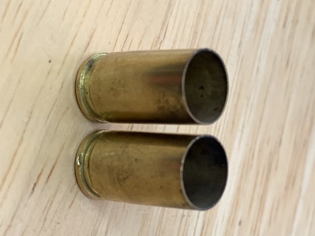

Can you see any marks on the casing from the extractor?

It is quite clear, especially in the top photo, that you're having failures to extract, i.e., the case is not being pulled out of the chamber. Take a look at your extractor, taking the slide off if necessary, and see if it is broken or something.

I field stripped the pistol and took a look at the chamber. It looks clean. I did a quick caliper measurement and it's close enough that it's probably not an issue since I don't trust the cheap calipers or the user to make a 0.001" accurate measurement. I also dropped live rounds into the chamber and tipped the barrel upside down...every one that I tried easily fell out. Not even a hint of resistance.
I'll confirm, yes this is an Italian gun.
I did look at the extractor with the slide removed and I don't see anything obviously wrong. No chipping, bent extractor, not moving etc.
So I was smart enough to grab a piece of brass from a FTE and one that didn't...but not smart enough to label them. I think the bottom one is the FTE one. It does look like the extractor skipped over the lip. I'll order another extractor spring and maybe extractor and try that out.
