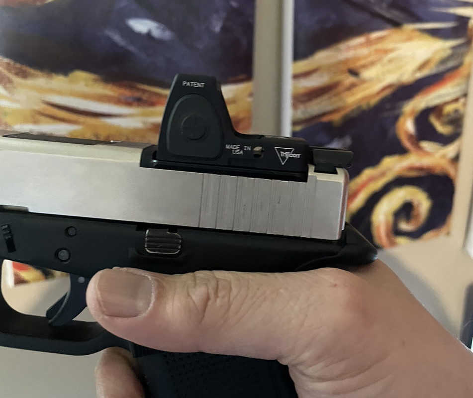

I had Maple Leaf mill a Glock 17 slide for me in February. I thought my RMR wouldn't fit either.
After some finessing and trying from different angles it dropped in. It's a near friction fit and milled so tight and so well I think it would probably retain the optic without screws.
Sit on your couch and be very patient and try finessing it for a bit. It may take you a half hour of playing with it.
I bet it will fit.

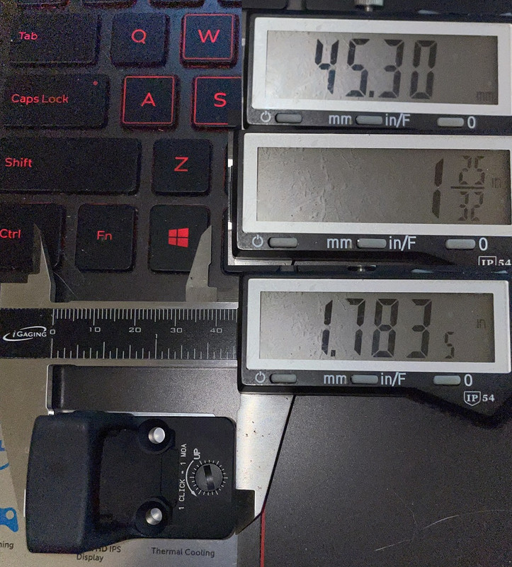

I'm hoping Chowser can get access to a decent set of calipers and see what is the size of this particular RMR. I have now measured more than 50 of them and it would be interesting if there is really a totally odd ball long one in existence.
Posts: 11968 | Registered: October 14, 2004Reply With QuoteReport This Post

found a caliper to borrow

Thanks Chowser. well within Trijicon spec. so discuss this with your milling guys. Appreciate the effort.

Maple Leaf told me to send in my slides for them to recut at no charge. They said a few batches were anywhere from .003 to .006" oversized and I'm not the first to contact them about it.

Four more RM06s came in so I grabbed one at random to measure.
1.781, 1 25/32, 45.25.
So a little smaller but definitely wouldn't fit.
Not minority enough!
Posts: 8833 | Location: Cleveland, OH | Registered: August 09, 2007Reply With QuoteReport This Post
both of the ones you have measured are normal sized RMR's, well within trijicon spec. I find it odd the Maple Leaf thinks any of these are actually oversized, but OK> I'm hoping that you will be able to measure your slide cut when you get it back and see what they decided to recut it to.

I just measured the other 3 rmrs and they were 45.22, 45.33 and 45.34.

I've received two slides back from Maple Leaf in the last month and handled one other, all RMR cut. Two were getting Holosuns and one an RMR. My slides were a 19/407C and 19X/RM06. The other one was a 45/507C. My first one fit fine, but the other two were extremely snug and required some... encouraging...to seat the optic. I did not measure cuts or optic bodies but would note that the RM06 was one of the FDE finished HRS models and may have been a little thicker with the finish.

Update:
Slides came back from Maple Leaf. The original RMR I sent it fits both guns now.
And one of the four newer ones I got for work fit both as well.
Stuck the old nonadjustable RMR on my 35 MOS.
