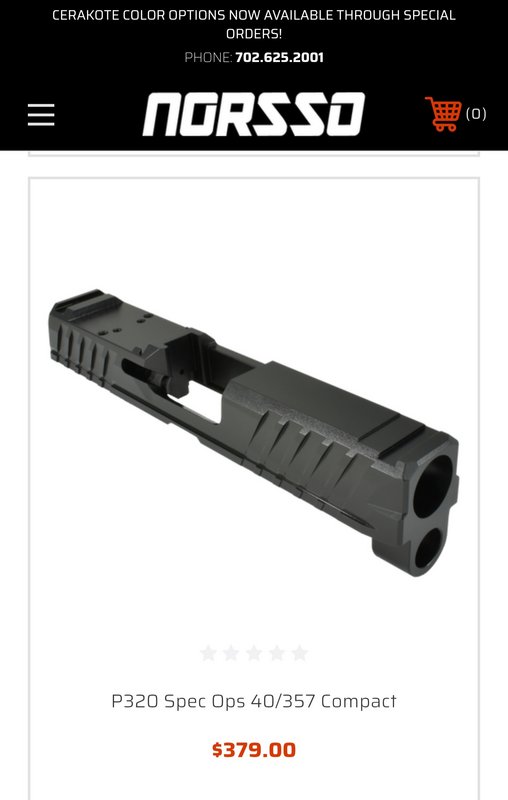

Shows out of stock. But email them and they will set you up. They did with me. They also have other designs.
