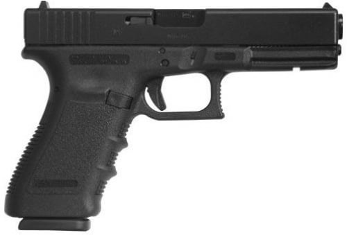

Just to expand on what Jerry said, here's a visual reference:
Glock 21SFs with that different style ambidextrous mag release were offered for a short time. They require G21 mags with the horizontal rectangular cutout on the front of the magazine, as seen on the two mags on the right in the above photo.
If you buy new Gen 4 G21 magazines, they should be compatible. Older Gen 3 and earlier G21 magazines won't be. If in doubt, email the seller to make sure they have the horizontal cutout on the front.
Another thing to watch out for is that these ambidextrous G21SFs also have a different rail on the front of the frame. It's a true Picatinny rail, not the standard Glock rail. So your ambi G21SF won't fit in most standard G21 holsters.
Ambi G21SF with Picatinny rail:
Standard G21SF with usual Glock rail:
