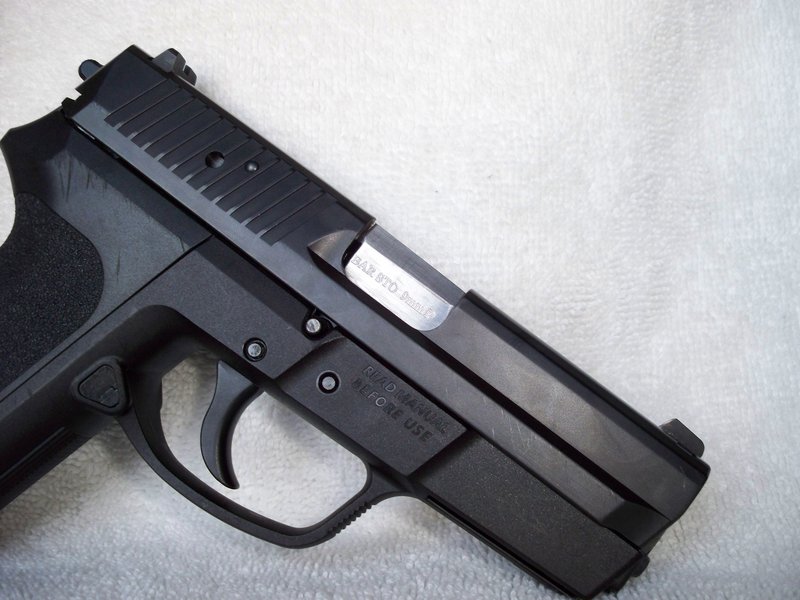

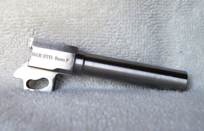

I believe you will need a 9mm slide to shoot 9mm. The case heads are different from 40/357.
Well regardless you STILL need a 9mm slide to shoot 9mm and a .40/357 Sig slide to shoot either of those...
Yeah? Ummm, no.
While I wouldn't use it in the 9mm configuration for SD, it shoots just fine. This "used to be" common knowledge among SIGPro fans. Of course I just posted that picture because I've never bothered to try doing it. Wink
I'll even add that I've used 9mm barrel/ammo with .40S&W magazines without changing recoil springs as well. I wouldn't trust that configuration for anything other than range use, but it shoots just fine.

Back when I had my 2340 I bought a factory .357 barrel and a Bar Sto 9mm barrel. Wish I knew then a factory one would have fit lol (this was back in 2006 or so). Alas all are sold now.
