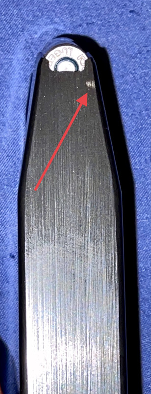

I’ve had several previous P365 w/manual safety and with all of them I couldn’t activate the safety unless the striker was cocked. This is by design and normal. However, a week ago I bought 2 P365 with manufacturer dates of 7/15/21 serial #66B690XXX & 7/1/21 serial #66B668XXX
I’ve fired 110 rounds through one and the other is unfired. On both samples at first the manual safety wouldn’t engage unless the striker was cocked. Then on both I was able to engage the safety without the striker being cocked but when I did so the slide was locked also and couldn’t be moved. Otherwise the guns operate normally and the sample I’ve shot 110 rounds through had been 100% through 60 rounds of Sellier & Bellot 124 grain FMJ, 20 rounds of Federal HST 147 and 20 rounds of Federal Personal Defense Punch 124 grain.
Has anyone heard of this malfunction? Also,is this mark on the back of my magazine normal or is this the trigger spring mark?

I have somewhat similar marks on my P365 magazines. It appears they are caused by the safety lever.
