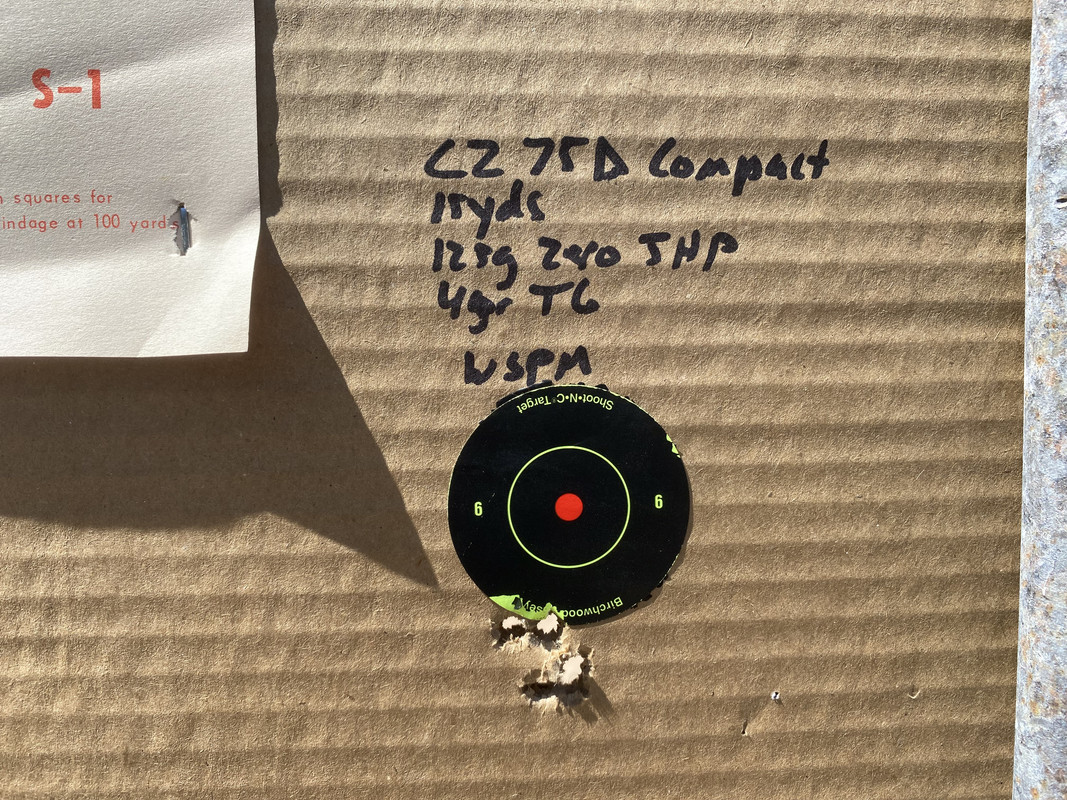

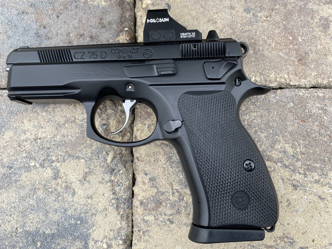

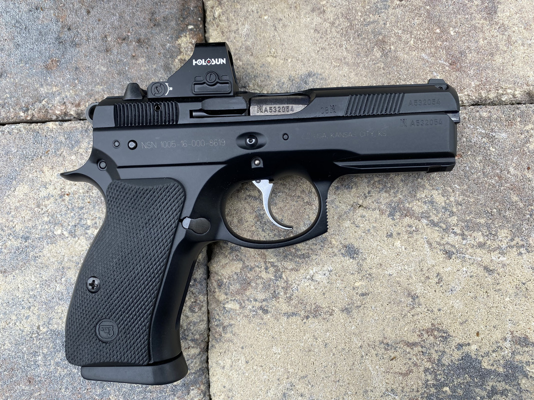

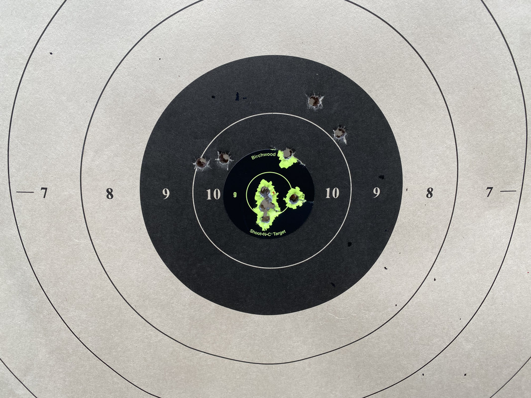

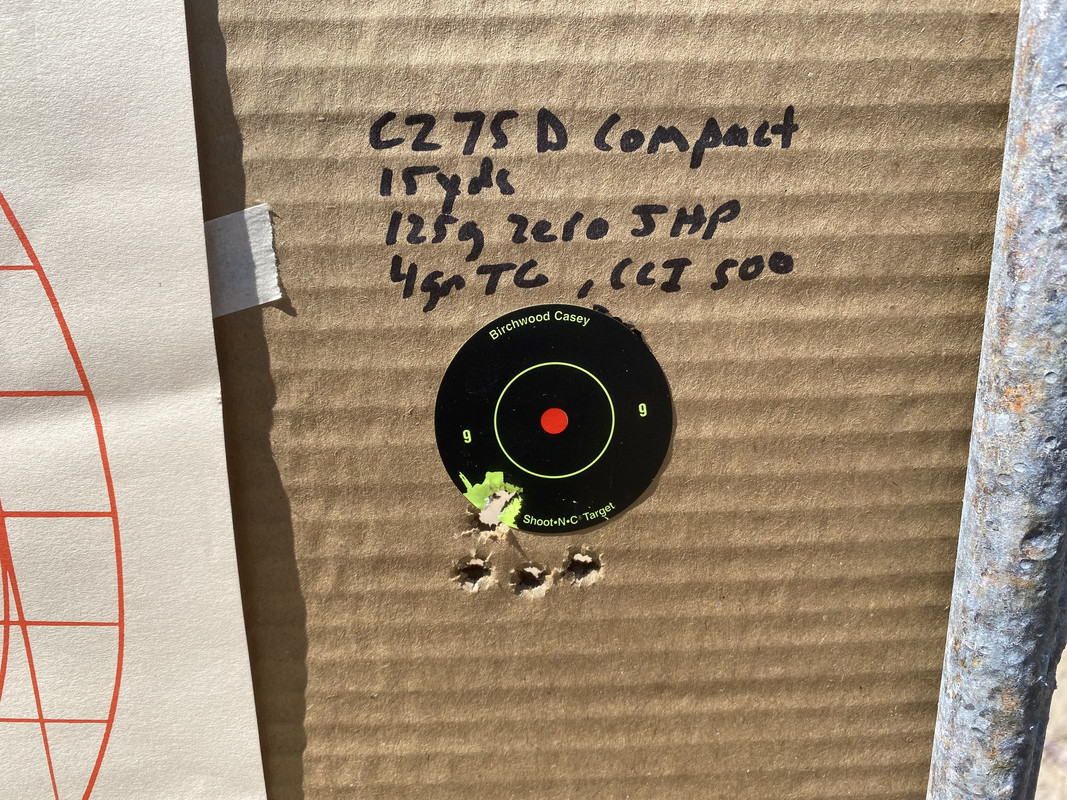

I may be the odd man out here but I cannot see paying those prices to get a better trigger pull. When you factor in the cost of the package and the absurd overnight shipping costs of a pistol, then you have almost if not more than to cost of the gun. The ultra lite kit with a 85 trigger, a new trigger return spring and pin for the new 85 trigger is less than $100 and is easily installed at home. It will drastically improve your trigger pull and reach to the trigger. I’m a nurse for Christ’s sake and installed them in a relatively short time with basic hand tools. I went from shooting 2” groups with my red dot pistol CZ75D Compact at 15 yds, to shooting groups half that size or less. Try it out, you may be surprised and save a lot of money for ammo to shoot in your gun Big Grin.
CZ75 D Compact 15yd groups prior to kit install.
Groups after kit install.

Take a look at the pic that usncorpsman posted.
Now consider this. If you put 5 rounds into that circle covering the COM for an adult male is he going to be walking away? I think NOT. Note that is damned fine shooting.
Now consider the effect of those mods done to the trigger? First off there is the reduction in the power of the Mainspring. As someone with experience working on a CS75B I am well aware that 80% or more of the DA trigger pull is a result of the Mainspring. As for the Single action pull mine was 4.5 lbs. out of the box which is what I consider just perfect for a carry pistol.
Point is when you start fiddling with the trigger system on any pistol you may be effecting it's reliability. Personally I do not want to carry a firearm that has a trigger that may fail at a critical moment. So I'll tune the heck out of a range toy but for a carry pistol the trigger get left factory fresh.
Not saying anyone has done anything dumb of foolish here, all I am doing is providing something for you guys to ponder.
PS; On that CZ75 I have race gunned the heck out of the trigger and slide springs. It's a blast to shoot and I shoot it will. However I don't ever plan on carrying it.

Great points and you are 100% correct on the mainspring and DA trigger comment. The great thing about the ULtralite kit is that it comes with two mainsprings. One will set off any primer on the market and is recommended for carry /self defense. The other is for Winchester and Federal primers only. It drops the trigger pull even lower. I have the carry mainspring in mine to maintain the reliability.
