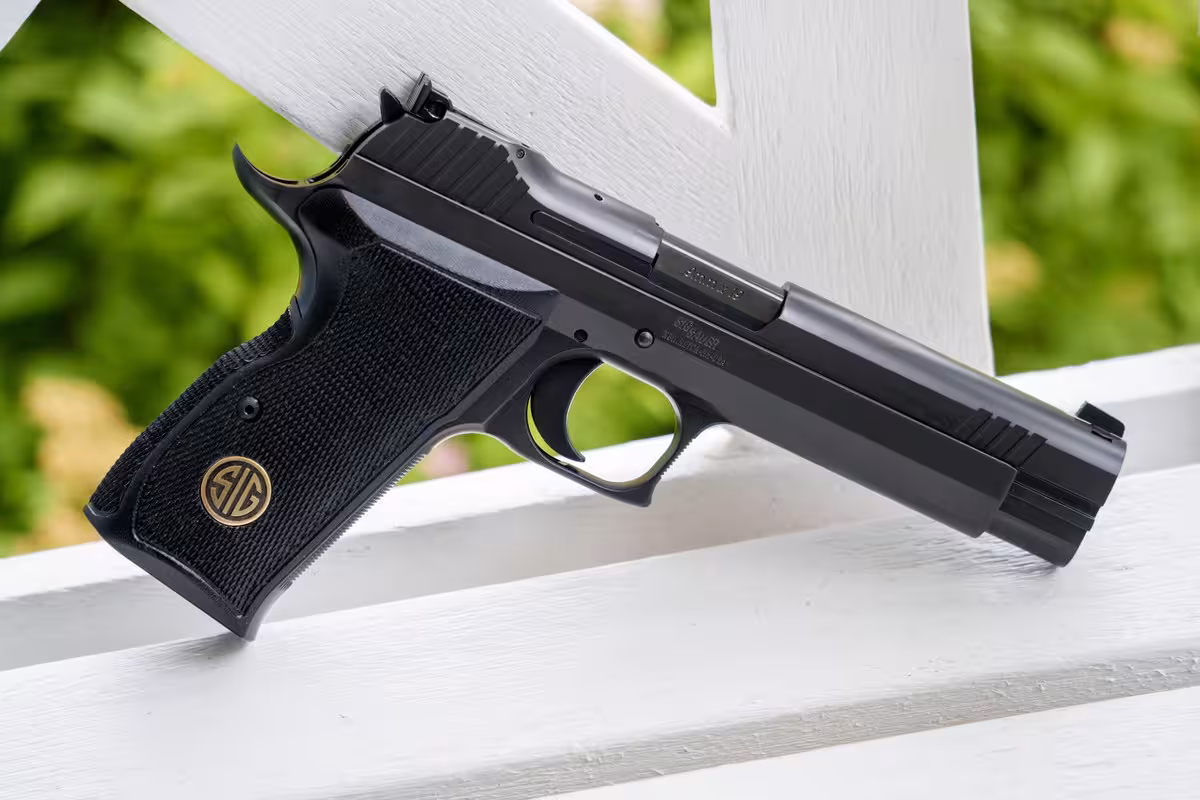

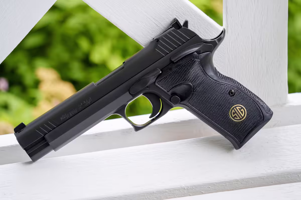

Hi all, I don't post here much at all, but I do enjoy reading. I wanted to show the grips that I had just customized out of a new set of Hogue G10 grips for my P210 Target. I had somebody on Etsy make a couple of Sig medallions out of brass (bigger than normal grip medallions, .625 to be exact), cut recesses into the grips with my pencil grinder, curved the medallions to the contour of the grips and JB welded them in place. Extremely happy with how they turned out. I Couldn't be happier at all with the P210 Target which my son bought me for helping him work on his new home.
