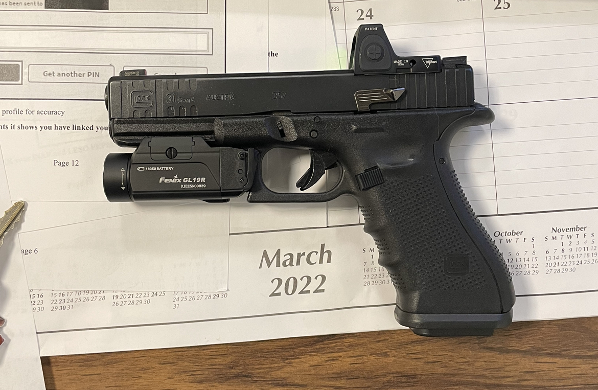

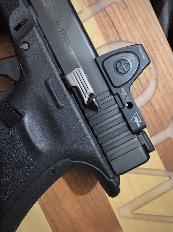

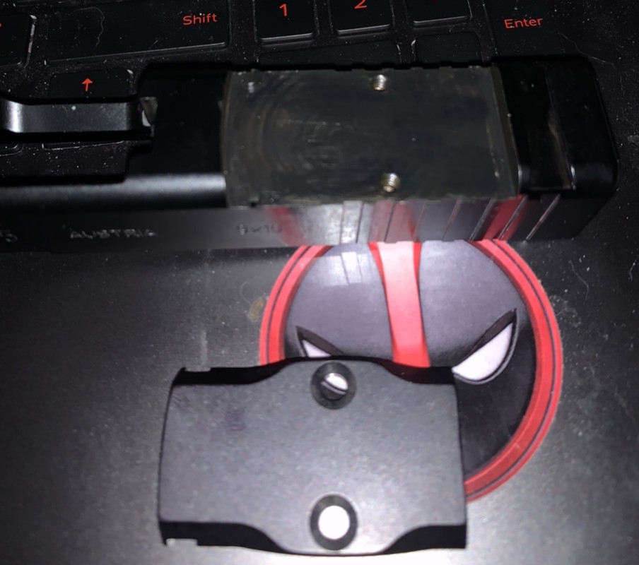

Maple Leaf milled one of my guns for an RMR. I then had them mill my duty gun for the RMR.
They have options on where the rear sight goes I believe. I left it alone.
This is my old duty gun. They did other slide stuff so I had the whole slide nitrided.
This is my personal Glock 45 where they did the optic cut and just put some tool black on the cut.
