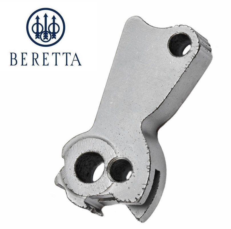

I was wondering about that when I was looking at Inox parts on Numrich and Midwest Gunworks. Some of the pictures of the parts looked plated and not very well at that. I love Beretta but I’ve noticed especially now and especially but not limited to Tennessee produced pistols you really have to inspect everything to make sure there are no QC issues. Most of the Beretta’s I’ve inspected have been fine but some I was really surprised they made it out of the factory.

they sub most of that stuff out. and, stuff that MGW has been sitting on isn't necessarily factory fresh....could have been seconds or overruns from way back and moved around a dozen times.
But yes, if I received that...I'd be sending it back.
