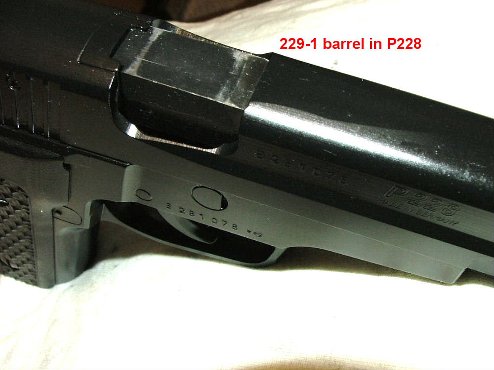

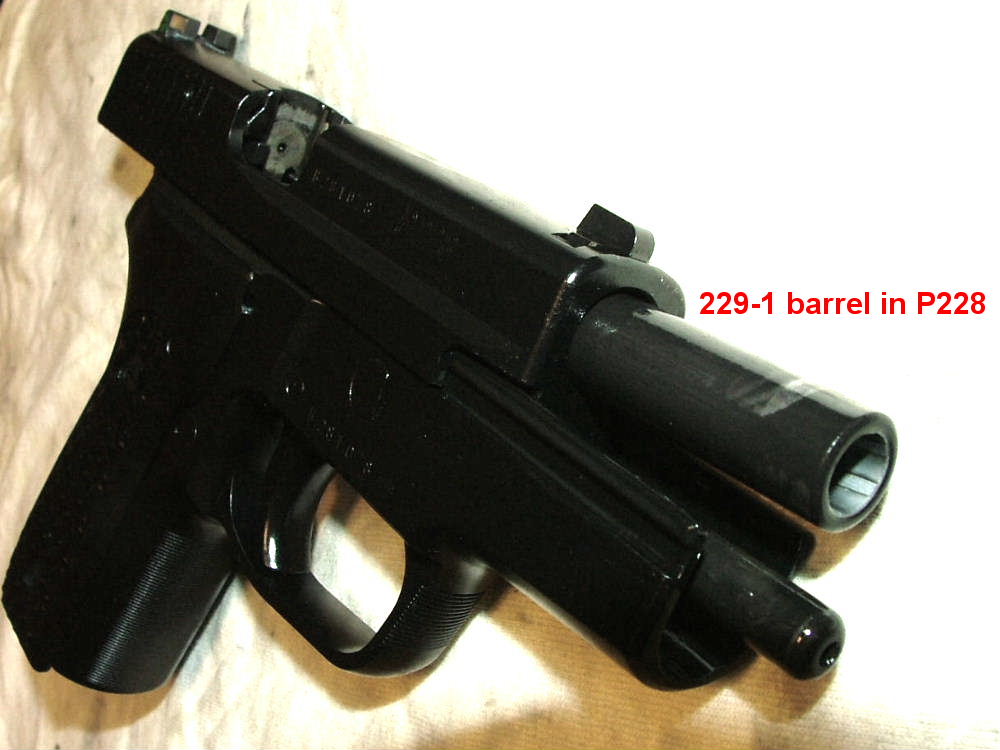

October 10, 2024, 09:26 PM
12131
The 229-1 barrel works in the P228. The P228 barrel will not work in the P229-1 (aka E2), however. I tested this years ago, when the M11-A1 first came out. Used its barrel in of my P228s, and it fit and fired just fine. The reason for this test was, at the time, there was a shortage of P228 barrels, and I wanted to see if you can use the 229-1 barrel in a pinch.
ETA pics, so you guys don't think I'm just BS'ing.
October 12, 2024, 10:16 PM
92fstech
I tried it today as well. The barrel out of my P229-1 does indeed fit, and seems to lock up properly in my P228. The reverse did not work, as the P229 slide would not go back on its frame with the P228 barrel installed. I did not try shooting the gun with the barrels swapped, but based on how it fit I have no reason to believe that it wouldn't work.

12131
I tried it today as well. The barrel out of my P229-1 does indeed fit, and seems to lock up properly in my P228. The reverse did not work, as the P229 slide would not go back on its frame with the P228 barrel installed...
There's a reason for that, explained HERE.
...Nice to know that the P229-1 barrel is an option in a pinch, though.
That was the reason for my testing at the time.
