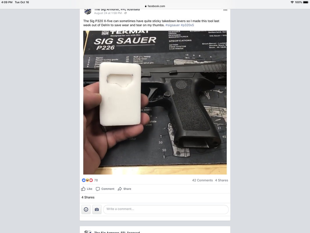

On sig Armorer web page he shows a jig he made from Delrin. Uses it for 320 takedown levers. You could use any durable plastic.

Picture of Jimg1960
Sorry..it’s on his Facebook page. Here’s a pic of it.

Burke should probably refine his design a little and sell the thing.
I am in for 10 bucks or so.

Someone should just make a little wrench like a plastic 1911 bushing wrench. Wilson Combat 1911 wrench are like $4.95.
