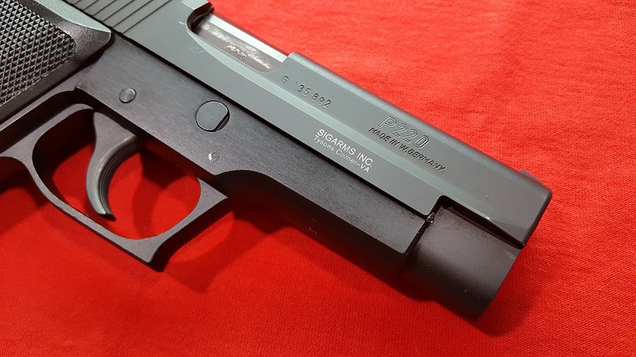

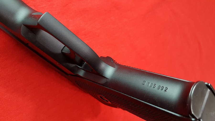

I bought a 1982 P220 with the heal release and made in W. Germany. All of the markings are on the slide except for the serial number on the front strap of the grip, which matches the number on the "dark" side of the barrel breach. Was it normal for W. German Sigs to have only the S/N on the frame and no other markings? From other pictures I've seen, that appears to be the case, but seems odd from an American point of view.
That's normal for the early P220s.
The frame serial number is on the front strap, the Nitro proof mark is on the right side of the frame just above the trigger guard. Yours should have the proof mark there, also. My ex-JF('85) P220:
