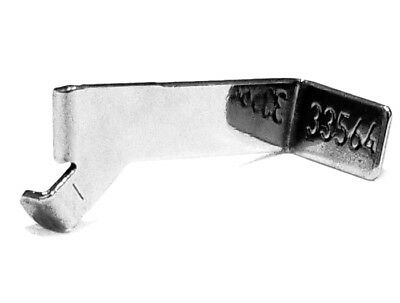

First, I would verify what connector is in your G43. This requires some disassembly.
You want the "Minus" (5.5lb) connector, not the "Plus" (8lb) connector.
The trigger/bar assembly and Trigger Mechanism Housing all come out together.
It is not hard to do, just don't force anything.
The pins push out easy and the assemblies lift out easy.
Once the connector is out of the TMH, turn it over and look for the ID mark.
My pic shows the "Minus" mark and the correct part number.
The part number may not be present.
If you have the "Plus" connector, the desired "Minus" connector is a $3.00 - $6.00 part depending on the seller.

The G43 trigger as it originally came from the manufacturer, was atrocious out of the box. At the time, Glock did not offer a minus (-) connector. Glock does now.
Glock does not offer a different trigger bar for the G43.
The original connector in the G43 was quite heavy and broke at about eight pounds.

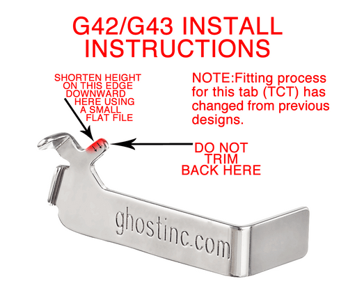

My 43/48 had the typical Glock factory trigger issues, drag, grind, whatever you want to call it.
I replace the connectors in my glocks with the Ghost Pro connector, it's designed to be custom fit to the bar, and it improves the trigger significantly.
Weight is important however eliminating the drag or creep seems to help keep the sights on target.
https://ghostinc.com/g42-g43-43x-48-pro-connector/
Posts: 28870 | Location: Gunshine State | Registered: November 07, 2008Reply With QuoteReport This Post

I swapped out the factory minus (-) connector on the G48 with a Ghost pro, pictured above, with the tab for overtravel, and put a Precision overwatch TAC trigger in it. The trigger is very comfortable, and the overtravel works as advertised. I had to remove the connector twice for file work.
Now, it's got a very nice trigger; still has a break, little or no over travel, short reset, easy takeup, smooth press-through, and I'm not trying to crack a walnut with my finger any more. The sight doesn't move. All safeties are retained.
This G48 has trijicon XR sights, a "glock gadget" striker control device cover plate, ghost pro connector, precision overwatch TAC trigger, and a Shield mag and mag release.
I can't find anything presently that I don't like about it.

I threw the ghost pro in the G43X, this time with a stock trigger bar and a vickers trigger shoe (flat trigger). It was much better, but a little gritty. Did a final pass with a file this afternoon on the overtravel tab on the ghost connector, and it's darn near perfect. Not much takeup, no overtravel, smooth push through a very acceptable break, no front sight movement.
With that, both the G48 and 43X are done, and identical, except for the trigger shoe. The Vickers was a lot less expensive than the Overwatch, and while the Overwatch is perhaps a tad more comfortable, both use a factory trigger bar, and both are perfectly fine (and much better than the original serrated trigger). The difference was the connector.
I didn't care for the trigger in the G43X or G48 out of the box; it certainly felt heavier than the advertised minus connector was supposed to be, and it wasn't so much the heaviness as the rough break and the overtravel. Even in dry fire I had a hard time keeping the front sight still. It's a lot better now, and it's still possible to pre-stage the trigger or prep it, and it's got a good, positive reset with factory springs, between shots.
I'm tempted to go back and put the ghost pro in my G43. I had a ghost in there at one point, and removed it when the factory minus trigger came out. The ghost pro with that overtravel stop makes all the difference. Money well spent.
