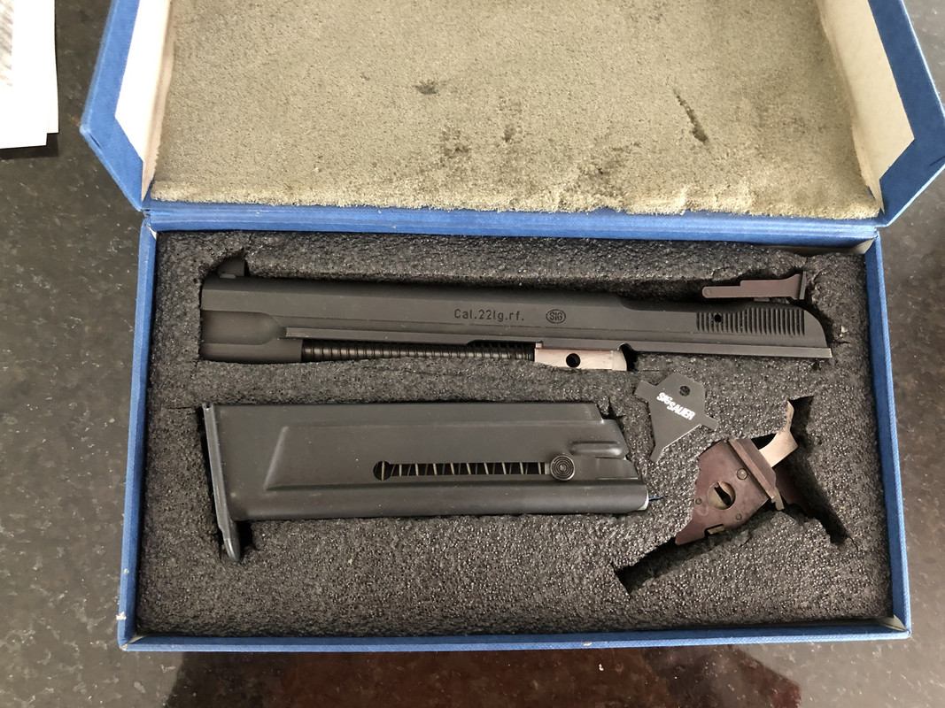

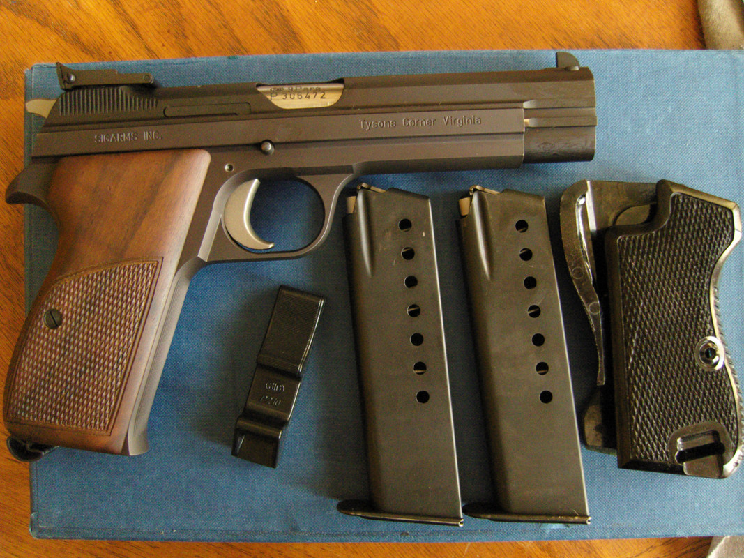

I have this rare full kit from the late 1960’s with both 30 Luger and 9mm barrels and the 22LR full conversion. While the entire kit is unfired outside the factory, judging from the test targets, it’s very accurate in every caliber.
The conversion itself is easy.
Posts: 1556 | Registered: September 20, 2004Reply With QuoteReport This Post
Neat! And a very classy box into the bargain. Thanks for posting. What’s that object above the 7.65mm barrel?
Posts: 10301 | Location: San Diego | Registered: July 26, 2014Reply With QuoteReport This Post
Thank you. This was built back before there was an Sig Sauer and the P210 was actually the only handgun Sig built. The full checkered grips were apparently only issued with these kits. I’ve seen exactly two other examples online (not in person) in all my years of collecting, so I don’t think Sig built many. The 30 Luger barrel matches. The 22 upper they pulled from P210-7 production.
It’s a tool kit
The funny thing is that the tool kit is higher quality than a lot of pistols these days.

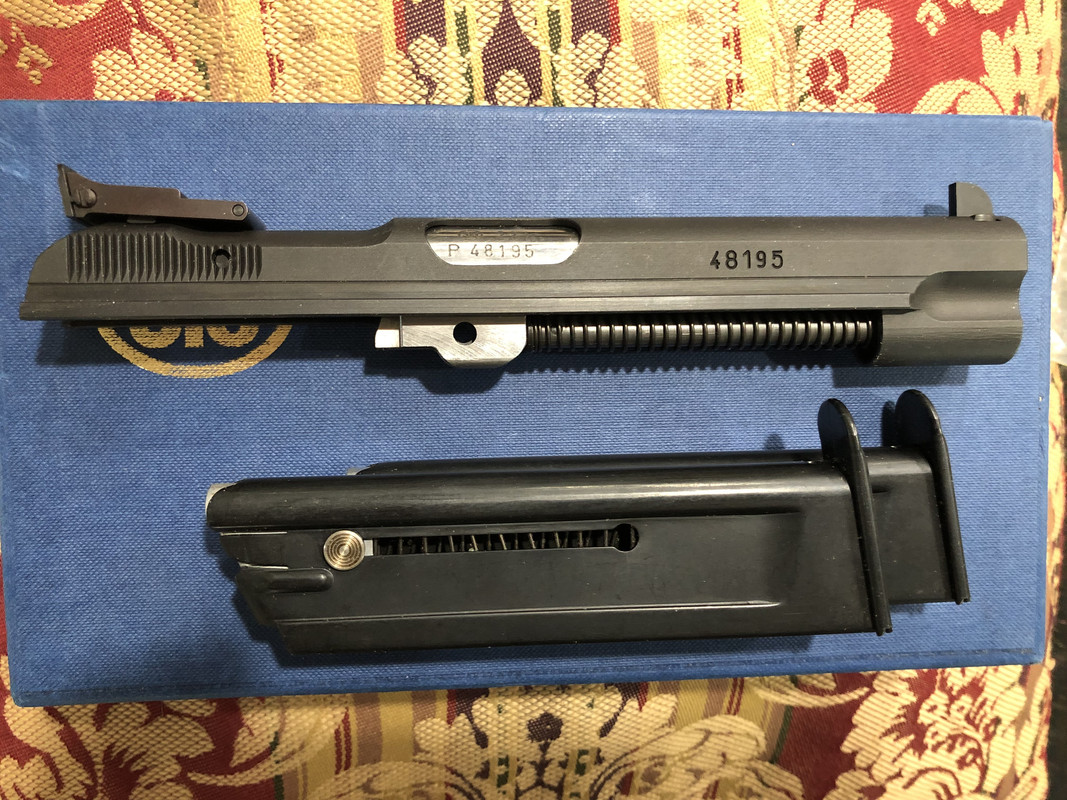

Thanks bac. One more question (until I think of another one Smile). What’s that object apparently clipped to the back of the left-most magazine?
Picture of MG34_Dan
That's a magazine loader.

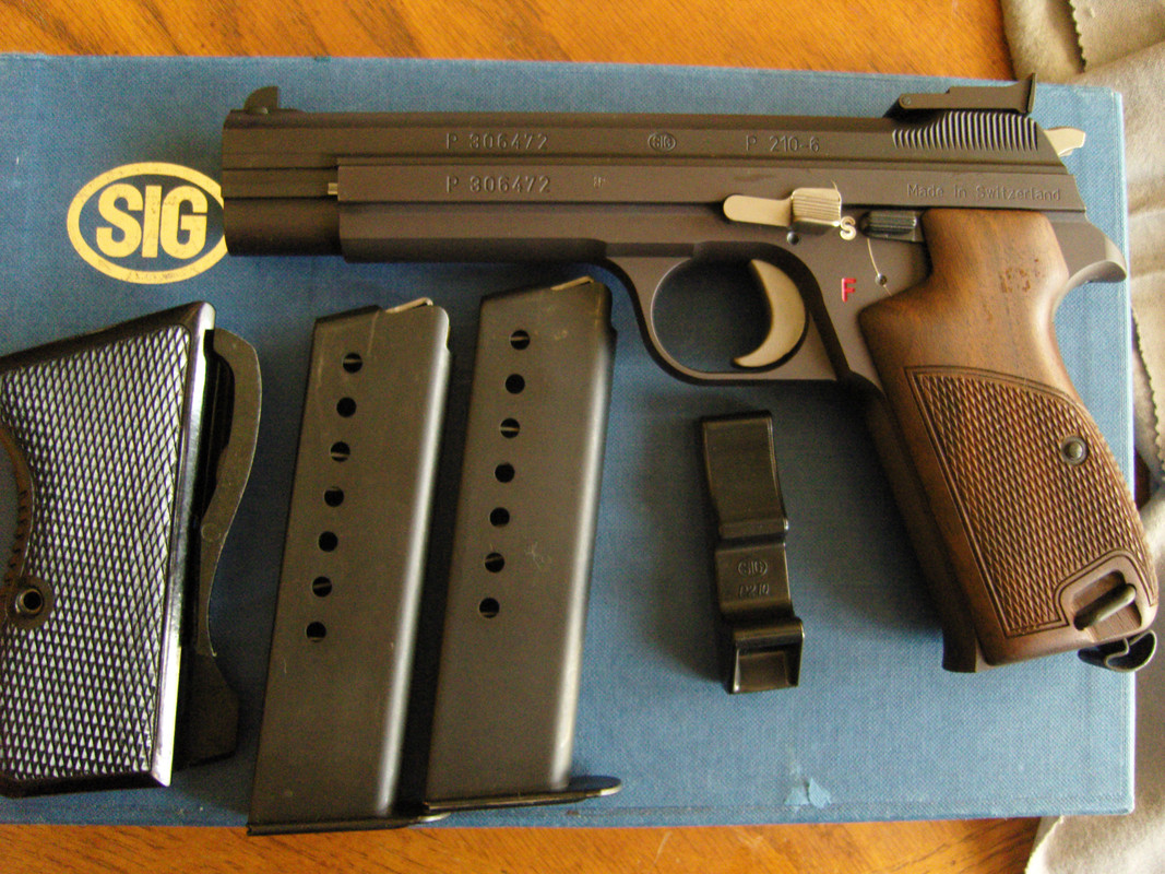

Originally posted by MG34_Dan:
Originally posted by bac1023:
Based on the serial number (the best I can make out), 51111, this P210-6 was manufactured in 1950/1951.
The serial number is 61111
The P210-6 didn’t even exist in 1951. The late 60’s was ideal. They had the steel hardening right by then and they were doing some of their best work. The frames were still forged then as well.
https://www.rockislandauction....ms-sp478-pistol-9-mm
Here’s a long ago link for an earlier model before the P210-6 name was given. Other than that, same kit.

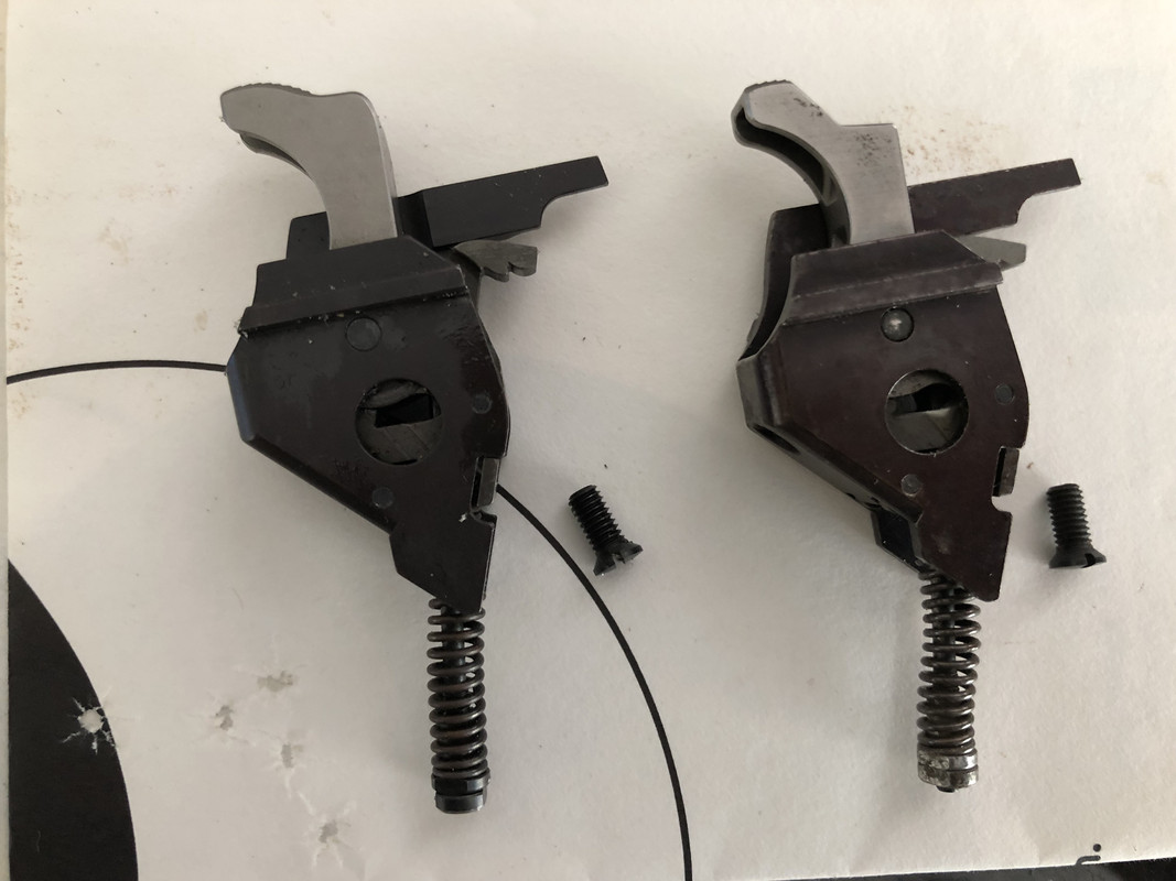

Picture of MG34_Dan

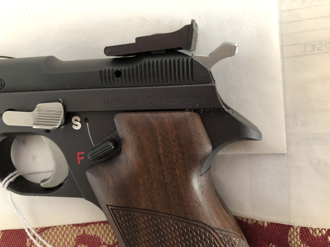

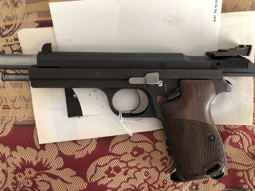

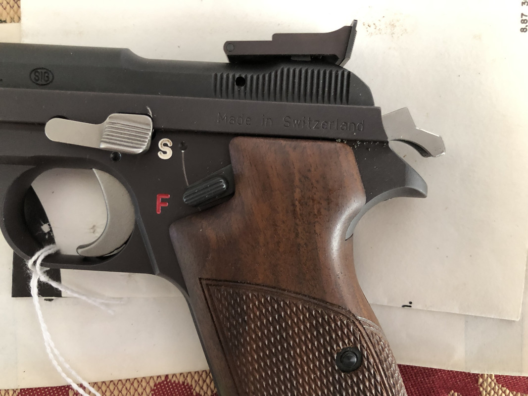

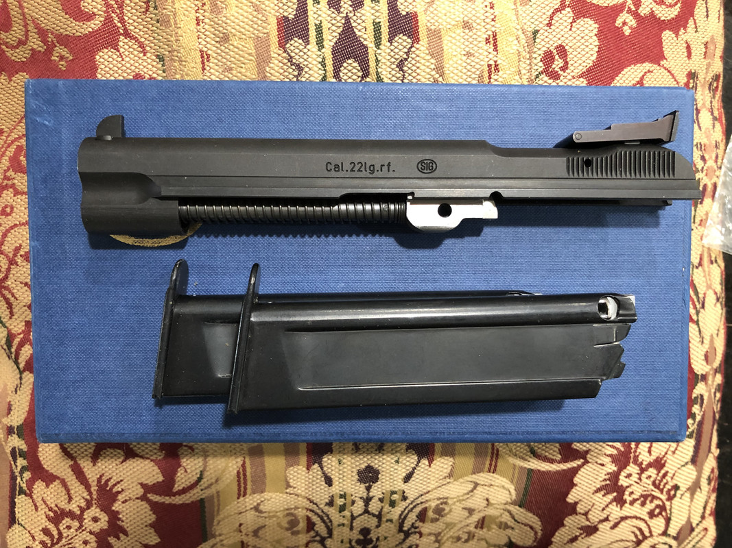

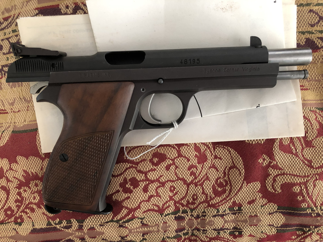

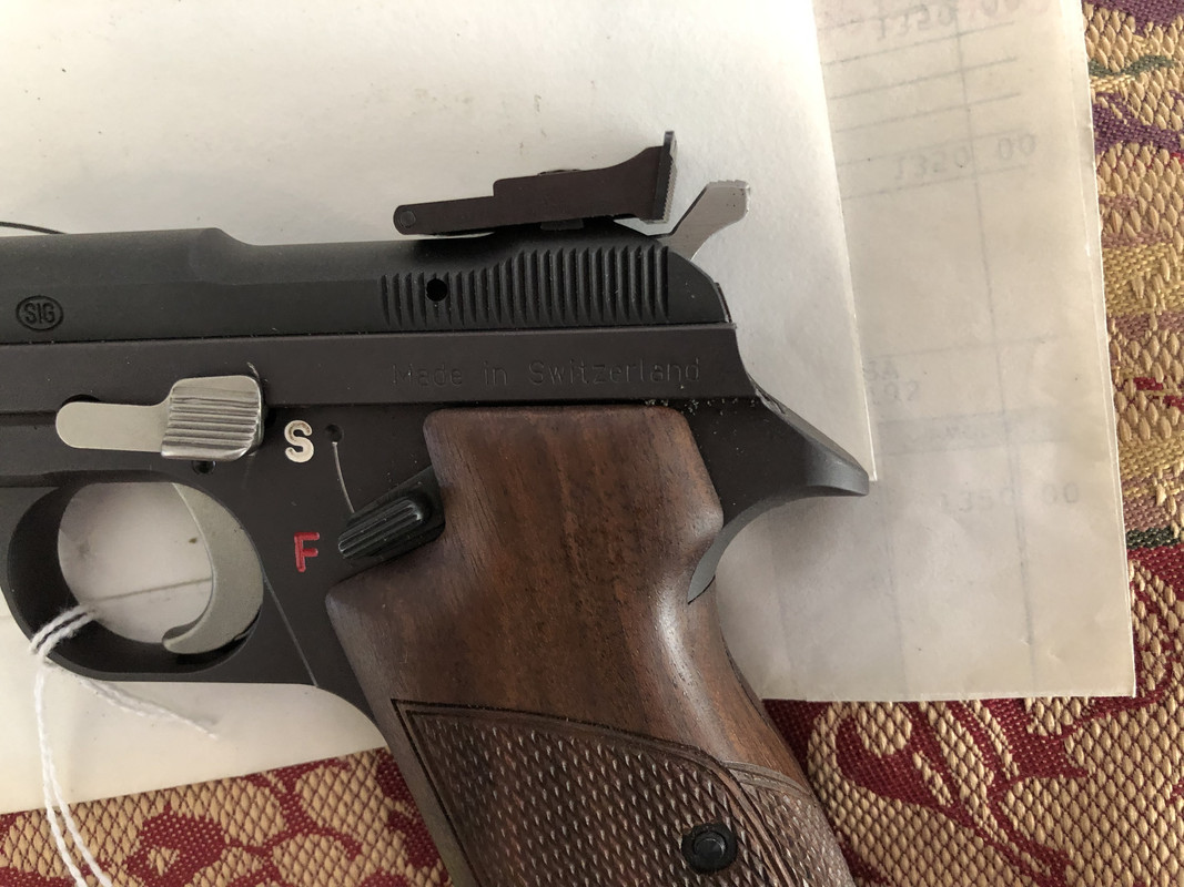

Here's my '80s P210-6 with an adjustable sight .22lr conversion kit:
Here is my P210-6 with the .22lr conversion mounted. Note that you must have the "Sport Hammer" equipped hammer pack installed. The standard P210 hammer will smack into the bottom of the adjustable sight conversion's rear sight.
Posts: 2209 | Location: Austin Texas USA | Registered: February 03, 2007Reply With QuoteReport This Post
Nice! Thanks for the photos and additional info. Nifty that the .22LR slide also has an adjustable sight.
