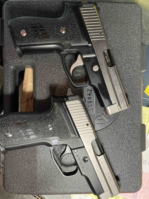

I just acquired my second Nickel slide 228. It came with correspondence between Sig and prior owner (and forum member) confirming it left factory w/Ni slide. However it differs from the Ni slide gun I already own (not factory confirmed) in that the takedown lever, trigger, hammer, grip screws are Ni as well. Was that customary? and conversely, did some factory Ni guns plate just the slide? They are considerably far apart in serial number as you see...
<IMG class="inline_image" SRC="[img]https://i.postimg.cc/wtkCHTLJ/0-30.jpg"> [/IMG]
https://i.postimg.cc/sXFsYM2n/0-30.jpg
Posts: 47 | Registered: February 22, 2006Reply With QuoteReport This Post
^^^ ^^^ The answer is under item H in the original post. Wink
Up until '94, they only plated the slide, for a 2-tone gun. From '94 on, they also plated the controls.
