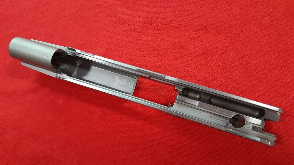

I am looking for a P220 slide to have it milled for a red dot, w/o using an adapter plate. Galloway Precision tells me the slide must not have: "the deep cavity to the side of the firing pin".
Anyone have any suggestions or images of the "deep pocket"? Would it be older slides, or newer ones?

nobody mills the folded slides, which is what I think they are trying to differentiate here.
Posts: 11842 | Registered: October 14, 2004Reply With QuoteReport This Post
Nobody mills the folded slide, yes, but they are talking about the stainless milled slide. Here is the "deep pocket" on the P220 MSE I used to own.

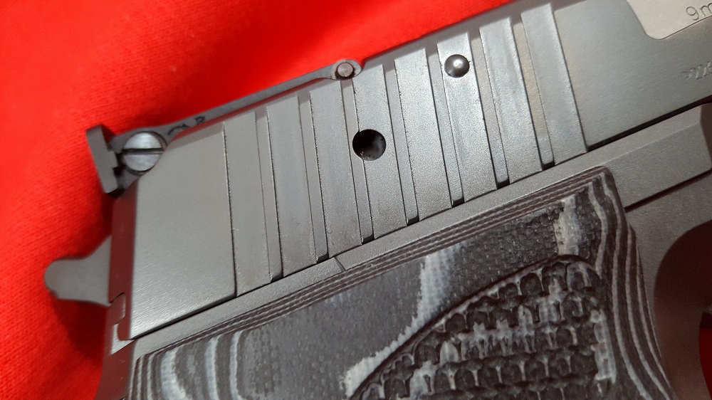

I thought you may have been referring to the ugly ass hole on the outside of some slides.
Posts: 18672 | Location: New Mexico | Registered: October 14, 2005Reply With QuoteReport This Post
That "ass hole" only appears on the milled slides with the internal extractor. External extractor P220s don't have them.

Thanks all for the help. The image from 12131 explains everything. I have a P220 being converted to .357 Sig at Gray Guns, but we have a long wait for Bar-Sto to make a semi custom barrel for this conversion.

The main point is to prevent opening up the inside of the slide when milling the top for the optic. There's a chance of those deep cuts like in 12131's pic being opened up when you mill the top flat.
I think I have a few with and without that deep cut. I actually have a carry slide over at Galloway right now for that exact service. I did measurements to show that we wouldn't expose the slide internals before I sent it on.
As to how to tell which serial numbers or manufacturing years will have optic milling compatible/incompatible slides, I'd be interested if anyone knows. For buying things online, sometimes the pics do not indicate what type of slide is in a gun, which makes purchasing for the plan of milling for an optic dicey. Sometimes you can get seller to post additional pics, but it would be great if we could know that this year, or this series of serial numbers had the incompatible ones.
