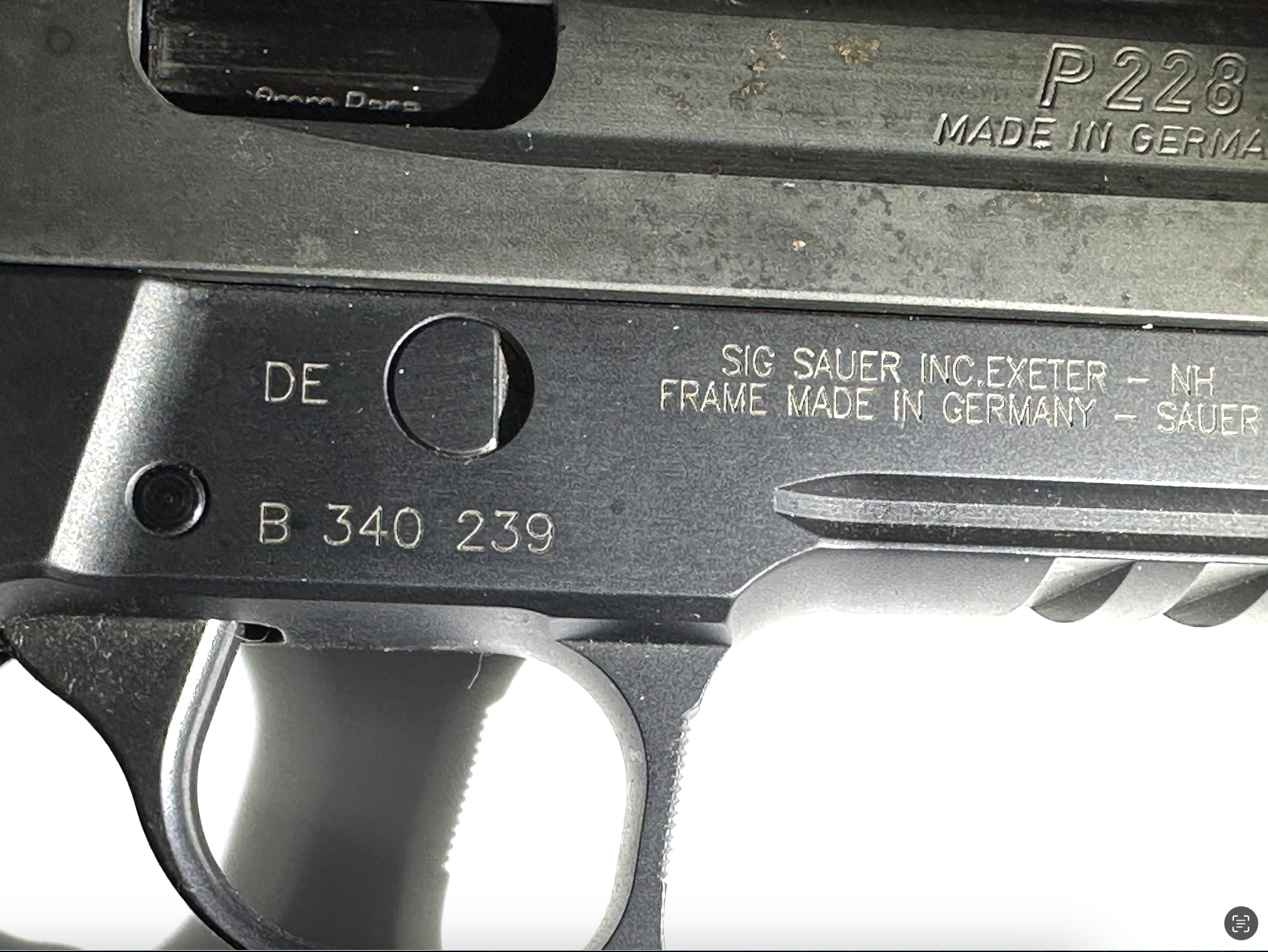

These were released in 2009 and 2011. It's just a P228 upper on top of the old P229(9) lower with rail. While it's not as common as the non-rail P228, it's not rare as a group. What do I mean by that? There are three variants of the P228R, listed below in ascending order of "rarity" (i.e., the least common is variant 3).
1. Most of these 2009 guns are just plain Jane P228Rs, with single serial number on the frame and nowhere else. The major parts were made in Germany, but final assembly was done here. Hence, no German proof marks.
2. Some 2009 guns had the “US" "M11” on the frame’s right side etched out. These “US" "M11” guns were never officially adopted by any US military outfits, despite unverifiable claims (mostly by sellers) on the internet that they were military contract overrun. The fact that they don't have corrosion resistant phosphate small parts and no "MP" on slide, breech block, barrel and locking insert lends support to the no official military adoption theory. "MP" = Magnetically Particle inspected to detect microscopic defects. The real story of the "US" "M11" P228R remains a mystery. This variant was also US assembled from German parts, has single serial on frame and no proof marks, like variant 1 above.
3. The 2010 guns, date code BA, were made, assembled and proofed in Germany, and have triple serial numbers (on frame, slide, barrel). These were imported by SIG NH and sold in 2011.
As to how it shoots, it shoots just like any other P228. And, comparing it to the real P229 (original or newer 229-1 version), some folks will tell you the P228 feels and shoots better, while others will say they shoot the same. There seems to be more folks in the former camp. To me, the P228 will always look like the king, but shooting wise, they are the same.

Here's mine, Serial number starts with B
http://rconnelly.com/sig228r.png
