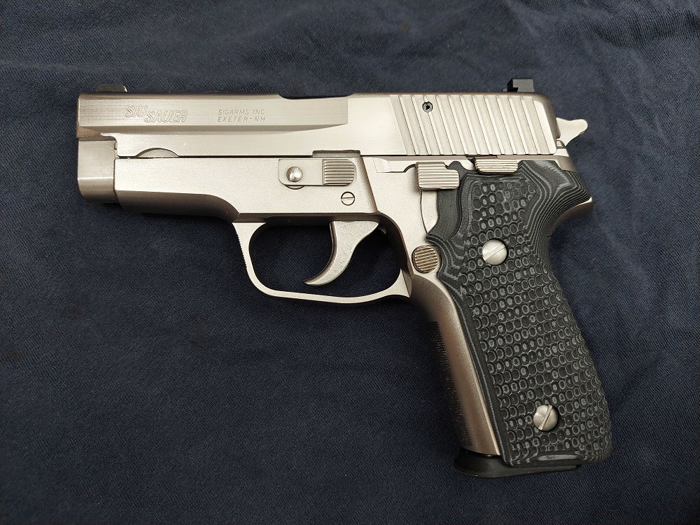

Changes not necessary. Not even the TBS.
This is my KA P228 currently wearing the new Hogue Contour Classic Piranha.
