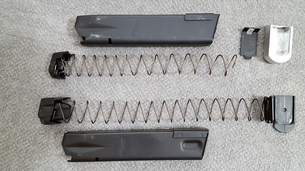

Here is how the Germans made the 25-rounder (from 20) for their X5 Open. Chopped off the follower's legs a little, shortened the spring and added the Plus2 base.

Yeah, but those "SWAT" mags are super pricey and stick out from the bottom quite a bit. The one in the bottom in the above post is the SWAT mag.
