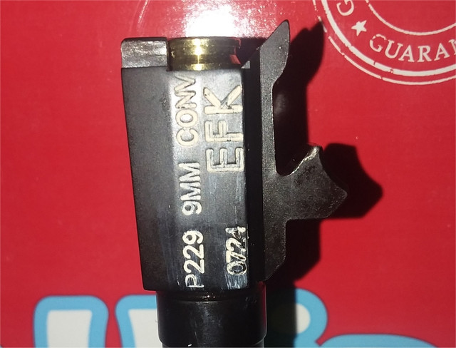

I have a P229 in .40S&W DAK that has had no problems shooting .40S&W ammo. I bought an EFK Firedragon conversion barrel and had light strikes, maybe 2 per magazine. All rounds would fire on a repull of the trigger. The first thing I'll try the next time out will be a 9mm magazine, but has anyone else had this trouble? As far as I could tell, I was fully in battery. I've had other guns with EFK and other brands of conversion barrels, but have never had this happen before. tia | ||

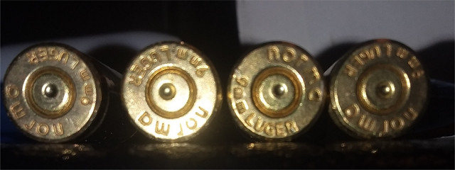

My immediate thought is that the barrel has excessive headspace, i.e., that the cartridge goes too far forward into the chamber and the firing pin doesn’t impact it hard/deep enough. If you drop a cartridge into the chamber, it should look about like this. If it goes in much farther, the headspace is excessive and the barrel is defective. Another possibility that occurs to me is that the firing pin strike is off center. Have you checked the fired cases to see if the imprint is centered on the primer? But if you got only two misfires, defective ammunition or primers that are too hard for the hammer force is not impossible. What brand? A DAK P229 should have a mainspring marked with red paint. When they were first released they used the regular DA/SA mainspring and that was too light for reliable primer ignition. The DAK mechanism does not compress the mainspring as much as the DA/SA mechanism and requires a more powerful mainspring. ► 6.0/94.0 “I can’t give you brains, but I can give you a diploma.” — The Wizard of Oz | |||

Well, you answered two of my three questions. Some of the primer strikes are a little off center but there seems to be some inconsistency. If the chamber is a little oversized and the cartridges are held in different positions by the extractor when chambered, perhaps some are off center enough to not be ignited properly. You might try wiggling a cartridge around in the chamber to see if it seems to have more free movement than cartridges in other barrels. But that's just speculation, and I don't know that firing pin impacts as far off center as I'm seeing would cause misfires. Did you check the mainspring? Is factory red? ► 6.0/94.0 “I can’t give you brains, but I can give you a diploma.” — The Wizard of Oz | |||

My brand new Colt Gold Cup Trophy had primer strikes much further off center than the 9mm conversion barrel pictured above. It did not experience any misfires. And that Colt Gold Cup Trophy? It's sold/gone now after a trip back to Colt where they replaced the slide. They should have replaced the pistol and didn't. My Dan Wesson 1911 has perfectly centered firing pin strikes. Perhaps now that CZ who owns both Colt and Dan Wesson, maybe they can train the butchers who work at Colt. Gold Cup by cee_Kamp 32ACP, on FlickrNRA Benefactor Life Member NRA Instructor USPSA Chief Range Officer | |||

I sent the barrel back to EFK and they said it measures within 9mm specs. Another trip to the range and with a 9mm magazine this time and the same Norma ammo, I had light strikes. I switched to Federal AE, and had no problems with either 9mm or .40 magazines. I guess I'd have to admit its the ammo, but I never had any problems with the Norma in other pistols. As an aside, I was going to try the EFK barrel in another P229. This other pistol has always been a little tighter when reinstalling the assembled slide on the frame. There is a little more rub where the bottom lug of the barrel starts to slide over the locking block. Once installed, it has no problems and functions correctly. When I tried installing the EFK into this one, I could not get the slide on to the frame. I didn't want to force it so didn't try very hard. Once I got home, I tried again and did various combinations of slides and barrels. The other frame is always tighter, but I was able to install the barrel on it and the slide moves normally. My original intent was to get a conversion barrel for this other P229 and not switch the one I have between the two pistols. I was considering a BarSto for the next one. | |||
