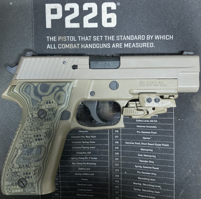

Picture of Blume9mm
Originally posted by patw:
I agree 100%. The E2 grips give the gun a different feel.
And it is much better than the factory bolt on grips.... as others have also concluded... G10s are close. I made my MK25 into a BBQ gun with G10 Hogue/Sig grips... but then CCR also helped with me converting it to 357 sig caliber and so it technically only half MK25 now.

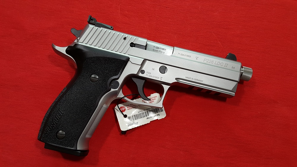

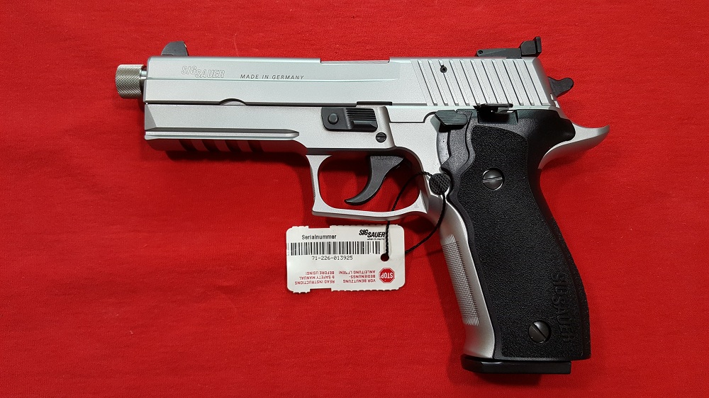

I like the E2 grip surface feel the most BUT despise the way it's mounted. No screws, snap-on, unstable. I wish SIG NH would make the E2 in 2 separate panels using grip screws like the Germans used to make for their P226 LDC II.
Posts: 30990 | Location: TEXAS | Registered: September 04, 2008Reply With QuoteReport This Post
