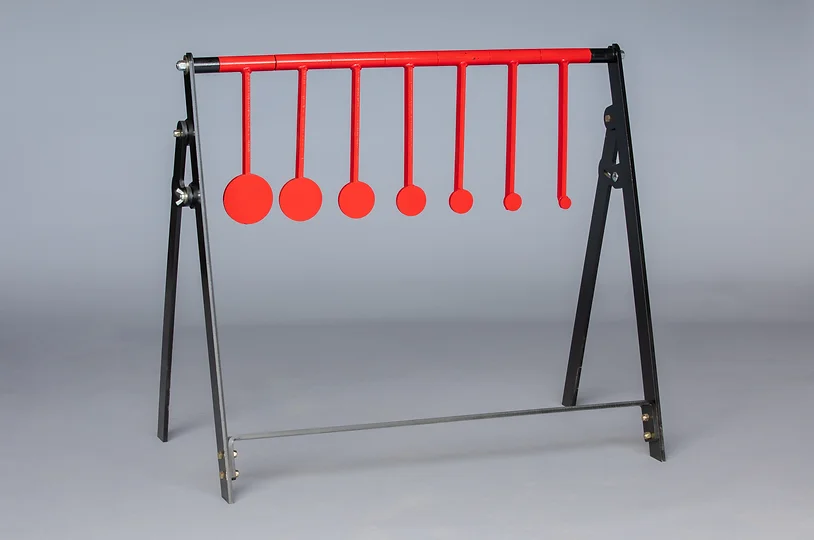

I still have the 8 hanging targets 6 and 4 inch. I have the 4 3/4 size ipsc targets that will be going back up. I have 4 8 inch circle targets going back up. I have one of these zero ballistics targets that will be going back in.
https://www.zeroballisticstarg.../limits-target-stand
If i can swing it some time this year i will add one of their dueling trees also.
https://www.zeroballisticstarg...dueling-tree-details

The right middle will have that swinging target. 3 4inch plates with 1 inch bullseyes behind them, Then 3 1 inch plates.
