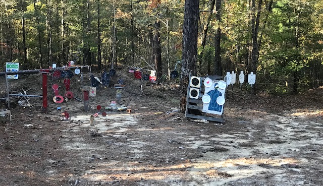

Last year i posted shots of my range backstop I built back up after some thinning of our trees. I was unable to get it much past 8 ft at the time due to the ground being to soft. I used it up until last week.
Over the last year it had compacted down by about 18 inches. So I wanted to make it taller, wider and deeper at the top.
I took all the plates and framing down this last week. Friday I added almost 2ft to the width at the top and 2 ft of height.
The biggest issue I had was getting the dirt to stay on the top. So i went and picked up some of the Yard wind blow down and an old deer target I had left over. I added that to the layers, it helped widen the top a bit. I then went and picked up several sets of wood pallets. I turned them upside down. I then began packing down the dirt on top.
At this point the top is at 8' from the actual bottom.
As you can see at the right side I extended the length of the berm by two pallets.
Here is the first layer of dirt on the top. Now pushing the berm to almost 9.5 ft. I have about 4 more bucket loads per pallet to put up on top and tamp down. So far it seems to work really well. We will see how it compacts down over the coming year.

A bit more work today. I am almost done with moving the dirt pile i have available for this.
I extended this 6 feet on the left hand side in a 40-degree turn.

This is what it looks like from my window at about 66yds.
This is from 90ft. I dont typically shoot from here. It just happens to be a spot i know the distance from. The tree line is 25 yds give or take to the targets.
This is at about 50 ft. The left sid turns in a bit more than the right. The left will give me a 6 ft rail to mount my ipsc plates too. Mostly to have a spot for working from the holster and defensive shooting. The center section extending to the far right side will hold 3 8 foot rails. On those i can mount my rifle plates, and 22lr plates for shooting from my closet window.

Sorry for the delay, I am still putzin around with it. It has been wet, and mostly a muddy mess. Slow progress the last few days.
I have the frames up, I am covering them with roofing tin to help stop the lead splatter from sandblasting them.
On the left target stand I mounted my 4 IPSC plate targets, the left middle will have my 4 8 inch round plates on top, and 4 8 inch hanging plates below.
The right middle will have that swinging target. 3 4inch plates with 1 inch bullseyes behind them, Then 3 1 inch plates.
The far right will have 8 4 inch hanging plates, and paper stands for accuracy work.
I bought the Bolt and chain kit from armortargets.com I fitted them to the 12 plates i have. I have 3 more 4" with 1" bullseyes coming. I have 3 3 inchers also.
My new plates and poppers have not arrived yet. I did get the rest up.
