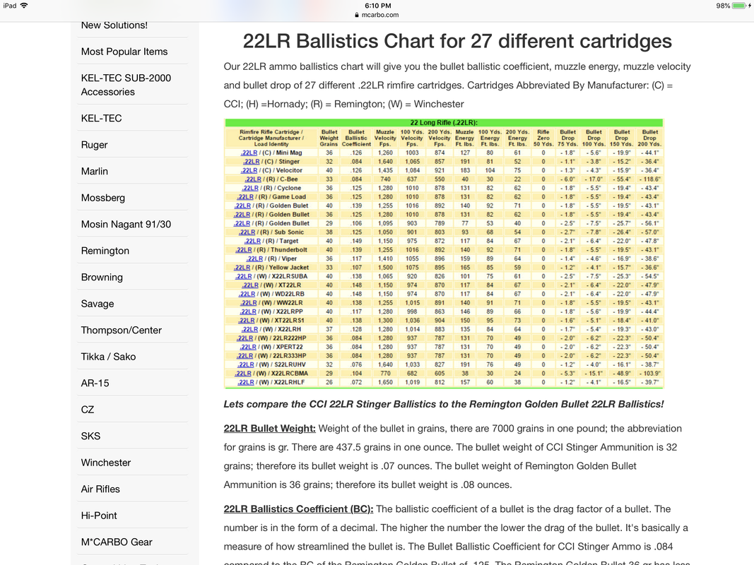

I find it interesting that a cci stinger at 32gr has a higher drag coefficient then a Remington Golden at 40gr. But achieves a muzzle velocity of almost 400fps faster.
The drag coefficient may affect the downrange velocity of the bullet, after it has flown some distance with more or less drag from the air. I don’t believe that the drag coefficient tells you anything about the effect of the barrel on the bullet velocity. Muzzle velocity is determined by the amount/type of powder, the bullet weight, and the length of the barrel. Generally, the lower the bullet weight the higher the muzzle velocity.
Also generally, a longer barrel produces higher muzzle velocity due to the longer time that the bullet is acted upon by pressure in the barrel; although at some length the increased drag of the longer barrel will outweigh the effect of the diminishing pressure. With pistol length barrels, the longer barrel will almost always result in higher muzzle velocity.

Thank you Pale Horse and honestLou. At some point I’m going to get a more user friendly .22
Based on the chart is the cci stinger the best to shoot? I know I’m missing something.
