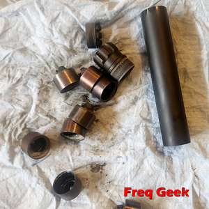

This was the first time I've cleaned my Spectre II suppressor. No one counts rounds from a .22. This can has more than 5,000 rounds through it.

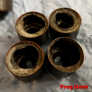

This is a cautionary tale of waiting too long to clean a rimfire suppressor.
The first step was to spray Sea Foam Deep Creep penetrating oil into the can. I let it sit for an hour. I then inverted the can and sprayed it again and let it soak for another hour. It was in a stainless steel bowl that I use in the garage.
Yuck!

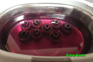

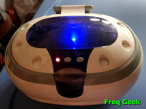

I used my ~20 year old Harbor Freight ultrasonic cleaner. I mixed Simple Green and water at 1:1.
After dozens of 3 minute cycles and soaking for several hours, I switched to 100% Purple Power. Many more cycles were tried followed by soaking overnight.

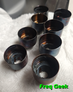

After the mild ultrasonic cleaner and Purple Power, the baffles look like much better. However, they're not good enough.

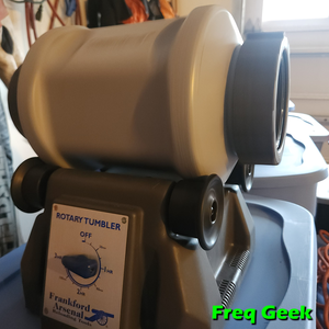

The next step is mechanical removal of debris. The next step was the Frankford Arsenal tumbler with stainless steel pins. This thing is fantastic! The old vibratory shakers and corn cob media have been outdated by this device.
FYI, the drum spins at 66 RPM.
The tumbler didn't remove everything. It would have worked better if I had cleaned the suppressor sooner. This carbon gunk was very hard and difficult to remove. I used a sharp scraper to get into the crevices.

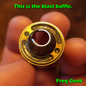

The remaining seven baffles are identical. The order of assembly matters, according to SilencerCo.
