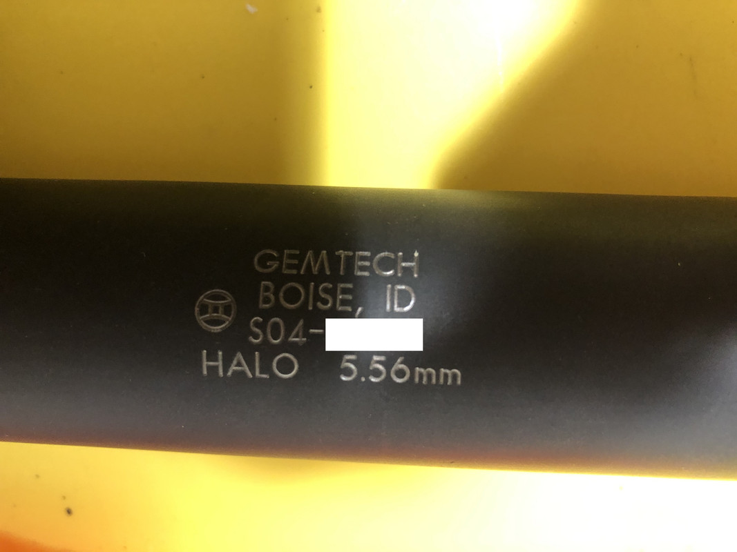

OK Here goes. This is a comparison of an older 2004 build HALO with a newer 2013 build HALO.
First the '04 HALO:
Suppressor mount with the lock/tension nut. Notice the long length of the lock/tension nut.
Suppressor mounted and locked onto the muzzle of a SIG 551-2 SWAT. This is a factory SIG barrel. The suppressor mounts and locks snugly onto the barrel. The lock/tension nut covers the entire flash hider.
Suppressor mounted and locked onto the muzzle of a Colt M16A1 Carbine. This is a factory Colt barrel. The suppressor mounts and locks snugly onto the barrel. The lock/tension nut covers the entire flash hider.
Conclusion; The '04 HALO will work just fine on a SIG 551-2 SWAT and Colt M16A1 Carbine.
Now the '13 HALO:
Notice the suppressor mount with the lock/tension nut. Notice the short length of the tension nut.
The suppressor will not mount onto the muzzle of a SIG 551-2 SWAT. This is a factory SIG barrel. The lock/tension nut is too short and not screw onto the suppressor.
Suppressor mounted and locked onto the muzzle of a Colt M16A1 Carbine. This is a factory Colt barrel. The suppressor mounts and locks snugly onto the barrel. The lock/tension nut fits into the second Blank Firing Adapter ring and does not cover the entire flash hider.
Conclusion; The '13 HALO will not work with a SIG 551-2 SWAT, but it will work just fine with a Colt M16A1 Carbine.

When SIG imported the 550s and 551s into the US they trimmed the diameter of the flash hiders. This was done so that a bayonet could not be mounted on the US imported barrels.
Back in the day, Gemtech made two different HALO suppressors; one to fit NATO standard diameter flash hiders and another to fit the thinner US imported SIG rifle flash hiders.
