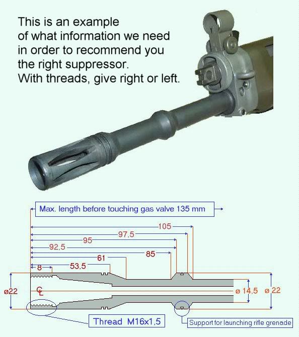

Oh, and I am confused as to what that image is supposed to mean, in the context of this discussion. It is an image of a neutered 550, with a technical drawing showing dimensions of a proper one, when we're talking about a 551. But it doesn't matter, I guess. So never mind.

Hold the phone! I just saw you added a picture to your original post! Your flash hider is different than my 553LB, and you should be good to go!
Posts: 3161 | Location: Northeast GA | Registered: February 15, 2021Reply With QuoteReport This Post
My hider resembles the 550, in that it lacks a flat spot, and has two narrower, shallower, grooves. Yours, having a flat and a larger groove will work with a few different cans, so long as it is 22mm.
HALO, M4SD, GP-NATO, etc. Go get 'em! If you wanted to be super cool, one of those B&T Rotex cans should work too.
I think the GP-NATO is worth a look, as they say it employs an improved baffle stack. As previously stated, I'd stay away from current-production Gemtech. Griffin is really the way to go, when it comes to NATO-mount with a collar or gate. Either should work on your gun.

OP,
If your muzzle looks like that pic in the first post, you can use this Griffin NATO adapter.
https://www.griffinarmament.co...-375x24-suppressors/
That is assuming one of your cans is threaded that pitch, or you buy one that is.
Also, as an amendment to my previous post, the Griffin M4SD will NOT work without modification of the barrel or the gate latch piece of the silencer.

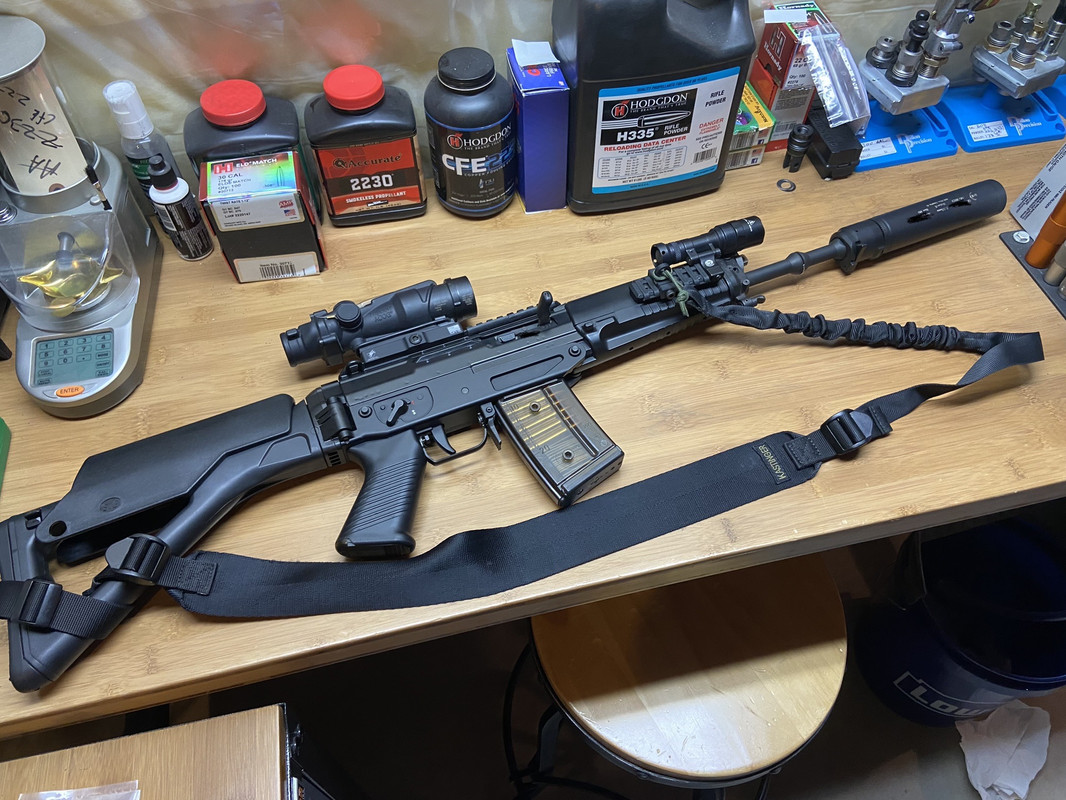

Update. Paid for the B&T Rotex X in July with Silencershop. Took a chance on the efile system being overloaded with amnesty paperwork and submitted a paper form. Approved and picked up the can today after 113 days. Christmas in November!!
[url=https://postimg.cc/BtFFXgDP]
