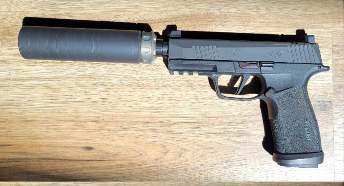

I got a SilencerCo Spectre 9 to go on a P226 with a LH metric threaded barrel. The back end of the can is threaded "Alpha." It comes with a Nielsen device/"booster" to run on semi-auto pistols. It does not come with a threaded piston so I started down the adapter road: LH threaded metric piston. RH threaded piston for all my other pistols. Fixed barrel spacer to run it direct thread on a MP5 clone. Then today I decided the MP5 clone deserved a 3-lug mount.
They sell an ASR mount for it. The Spectre 9 is rated both subs and supers for 300 Blackout but I have another can for that. You can't hot swap these mounts, it is not instant, but as you can see, the can will fit on nearly anything. I think I know what this will eventually lead to for me is a 2nd Spectre 9, or a 2nd can with alpha threads that all this hardware fits on.
If I were to do it over again, I might have sold the LH barrel from the start, skipped the LH piston, and bought a RH aftermarket threaded P226 barrel. It would make swapping between pistols much easier. Good news is, if I buy an H&K pistol in the future I'll be set.
At least I bought 2 SiCo cans during the $200 credit last fall so I got 2 threaded pistol barrels, and the fixed barrel spacer in the credit. Oh yeah, and I got free a SiCo t-shirt out of the deal Wink
There are other cans that are as versatile but I'm happy with the sound suppression especially compared to the weight ratio for this setup.
Edit to add P365 Tacops with Spectre 9 pic:
