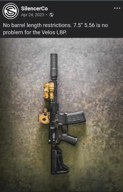

I was wondering what would fit a 7.5" 5.56 barrel and realized SilencerCo Velos does not have a minimum barrel restriction. I have the 556k and the 762 models. The 556k would not go in the quiet category, it is a knock the sound down to a somewhat reasonable level suppressor (I can tell a huge difference from unsuppressed on a 12.5" SBR). The full size 556 and 762 take the suppression to another level with 556 ammo. The 762 works pretty well if you wanted an all in one 556/762 (that's what I bought it for).
I see the Velos models rotate on sale at Primary Arms (paperwork thru Silencer Shop) for $799 (that's including ASR mount & muzzle device). Some folks don't like Velos because they are Charlie thread pattern instead of HUB mount. The ASR system is 3 oz heavier than Plan B setups, but they work well and are tough. If you want to switch to Plan B you can buy an aftermarket Charlie/Plan B mount thru Rearden.
This message has been edited. Last edited by: ibanda,
Posts: 2517 | Location: Texan on the north side of the Red River | Registered: November 05, 2003Reply With QuoteReport This Post
The Velos is also fucking loud lol. Big Grin Razz
