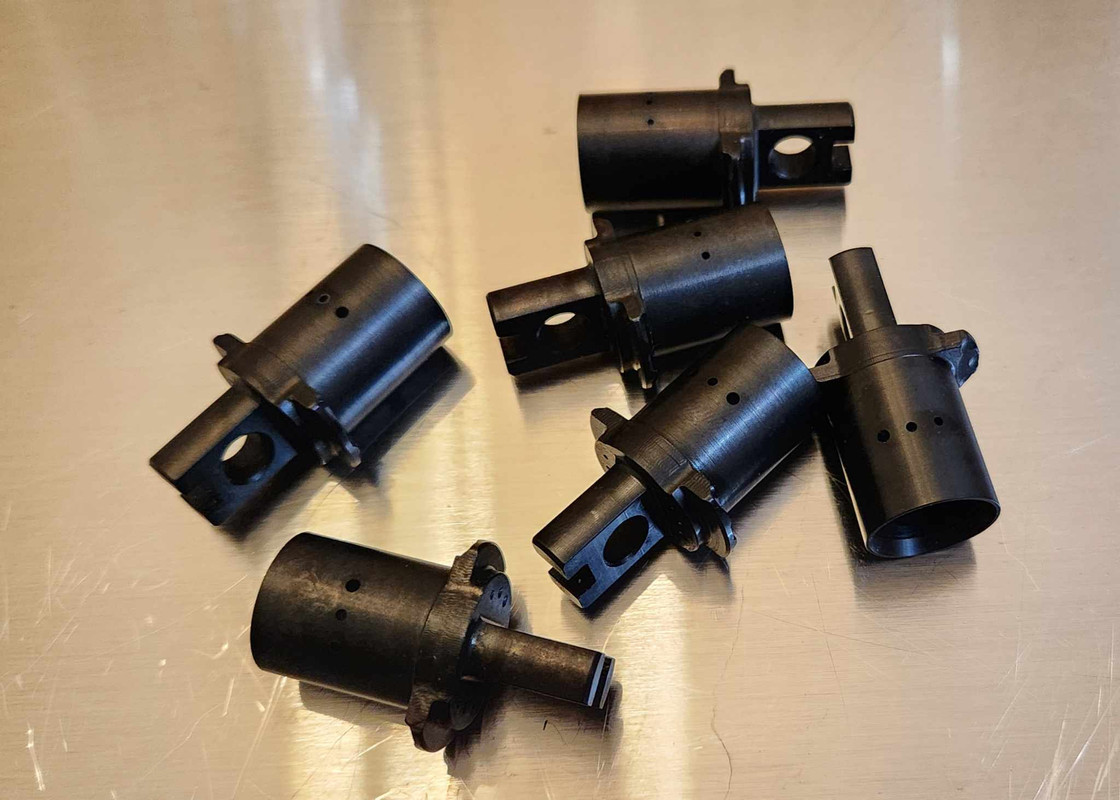

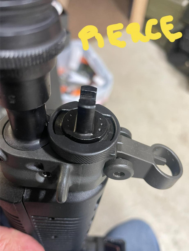

Picture of gw3971
https://www.pierceprecisioneng...k2dr-200-bpat5-7r9s6
[/url]
[url=https://postimg.cc/Tyb02gLb]
6-Position Gas Regulator for Sig 550/551/556 (14mm piston) (2nd run, With Lockouts)
$85.00
4140 Alloy steel, black nitrided (isonite) for wear resistance & corrosion resistance. Adds up to four more settings if your original only has two. Has the original two port sizes (regular and adverse) for a 550 or full length 556 rifle (as well as a few others in their list of models). Also has four more settings with reduced port sizes for customizing your settings to your ammo or suppressing. Ports are labeled by dot sizes on front of regulator using the spring detent as the “arrow” indicator for what setting you are on.
**These regulators are the second run that have lockouts and require pressing the detent manually to move to takedown position.
Port 1, 1.6mm
Port 2, 1.3mm
Port 3, 1.2mm
Port 4, 1.1mm
Port 5, 1.0 mm
Port 6, 0.9mm
Well first..im gonna try those gas regulators. the price and aperture options seem interesting.

Nothing special, hrcjon. Take off the handguards, clamp the gas block in a vise with some non-marring jaw inserts, and remove/install the muzzle device.
I'd recommend one of the valves shared by gw3971 as well. The 16" gun will work OK without one; I have also had success modifying factory valves. For what they cost, this new aftermarket option seems unbeatable.
Posts: 3208 | Location: Northeast GA | Registered: February 15, 2021Reply With QuoteReport This Post
Can someone here vouch for those valves and the source?
Posts: 11919 | Registered: October 14, 2004Reply With QuoteReport This Post
